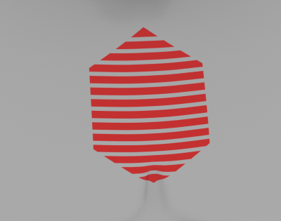

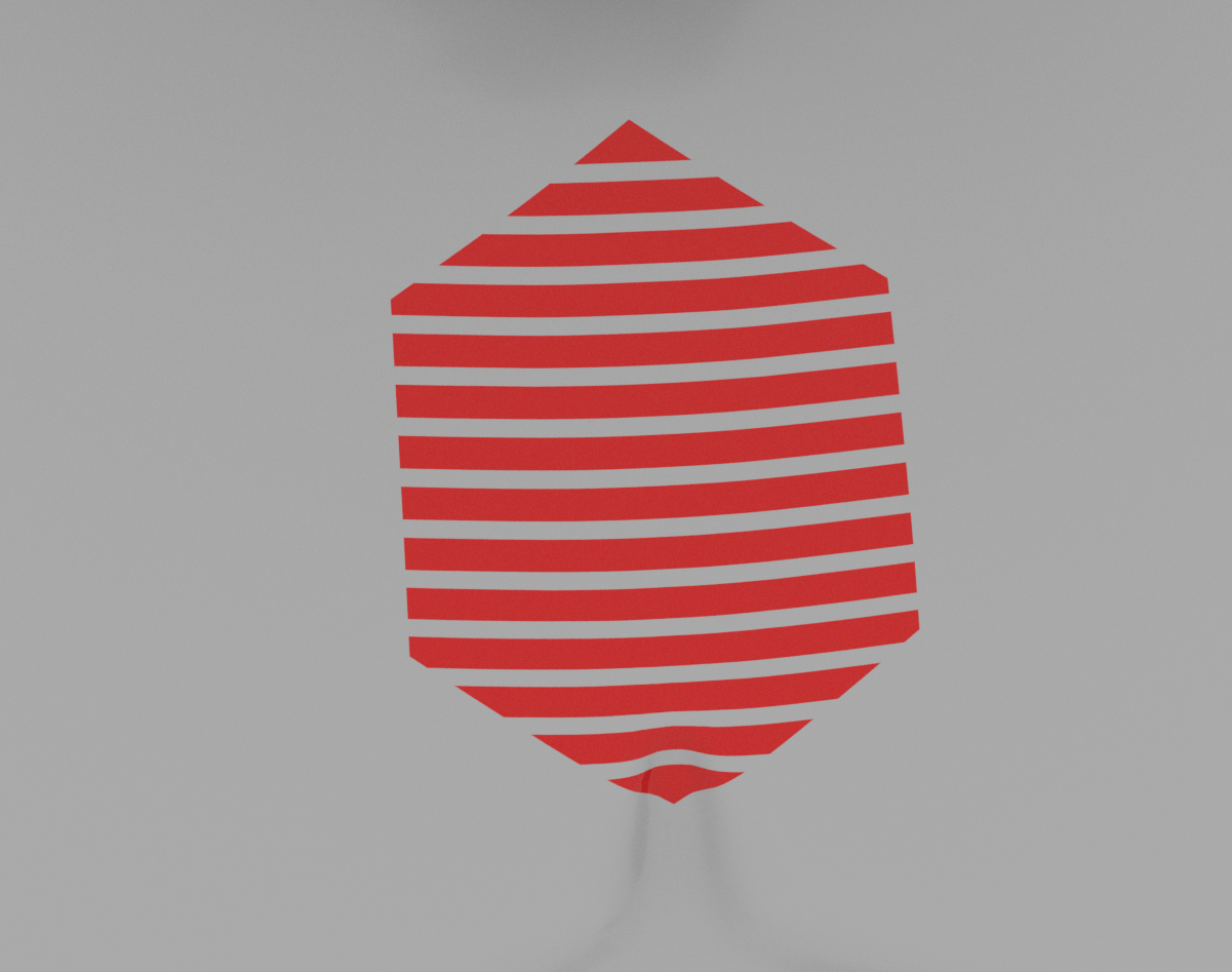

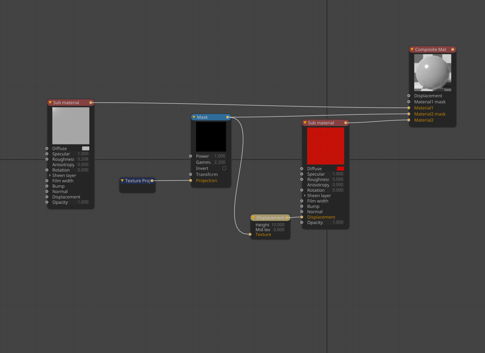

is it possible to have a decal mask and displacement inside composite material?

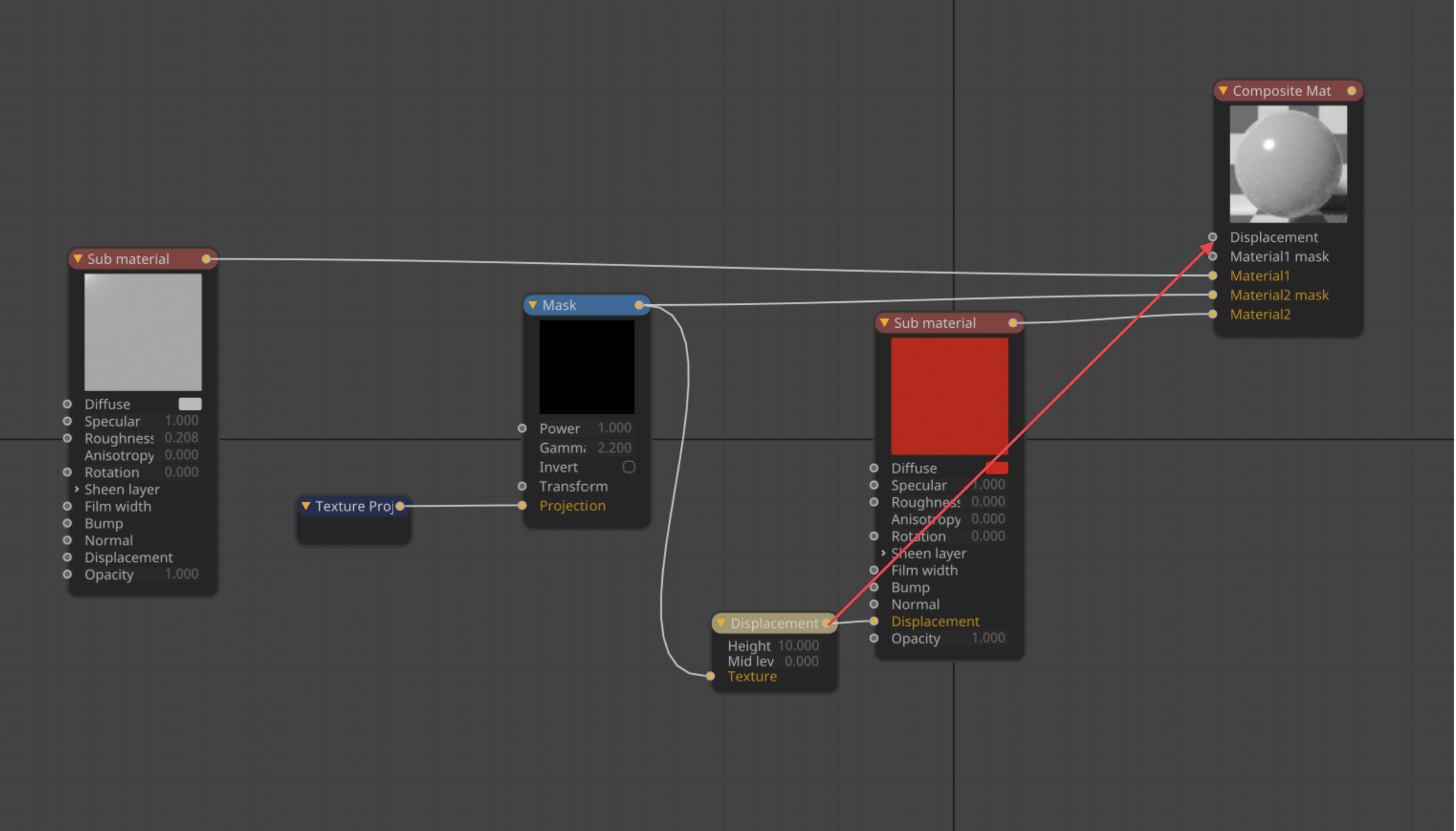

you need to connect the Displacement node to the Displacement pin of the Composite Material, not to the SubMaterial pin:
