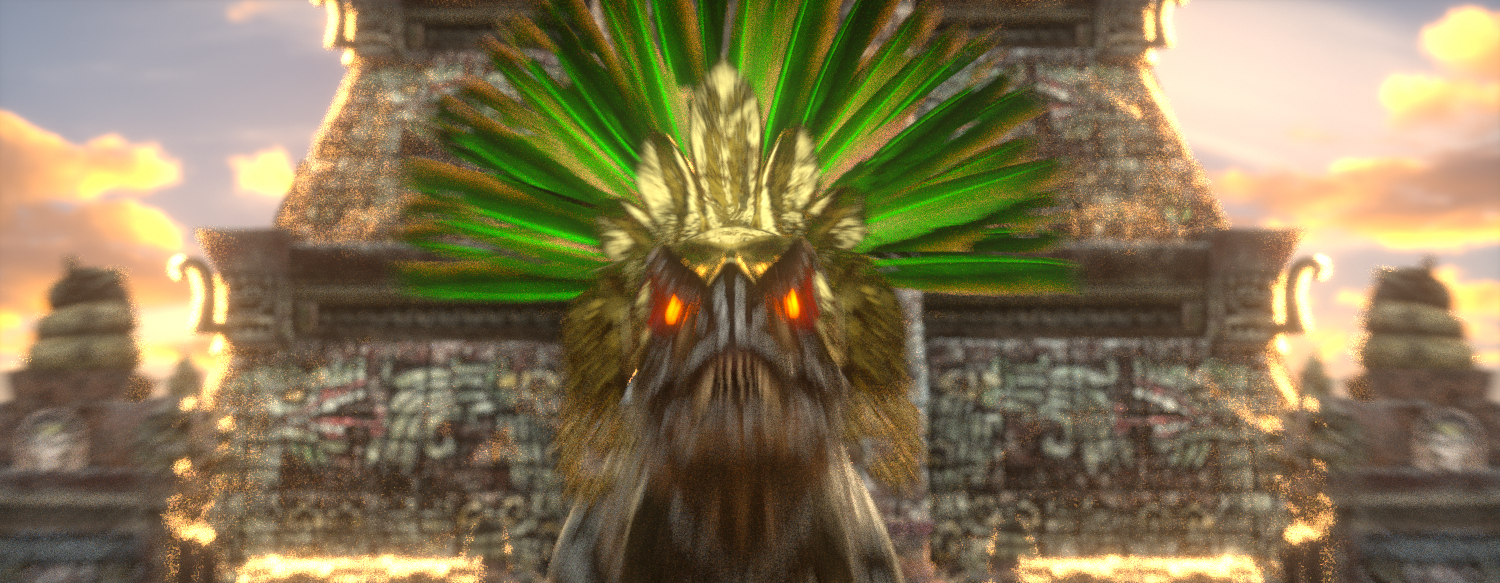

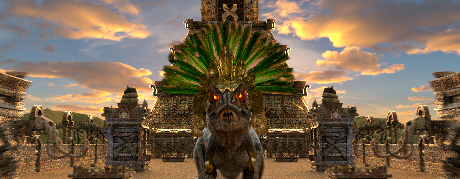

I've been working in this scene for a while and i cant figure out whats causing this issue.
I narrowed it down to the camera moving backwards in Z space. When this happens my scene turns brighter/ darker for a few frames. It's a very quick move but it only happens going back, when i move forward everything seems fine.
I've played around with time shift/ shutter alignment on the camera tag, and put octane tags everywhere but im getting these flickers still.
I've looked around but cant seem to find any solution so any help would be appreciated.
I'm working in R26 C4D with 2022.1 R7 . I also tried it in R23 with the latest Octane plug in but im having the same issues

weird, you should try in C4D R26 with c4doctane 2022.1.1-R6:
https://render.otoy.com/customerdownloa ... R6_win.rar
If not enough, try to replace the objects with cubes/primitives, and share the scene so we can have a look.

Thanks for getting back to me.
Soo as I was getting the file ready to send to you. I found what the issue was. Had this random huge Sphere that was causing issues.
