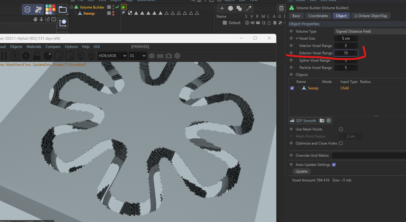

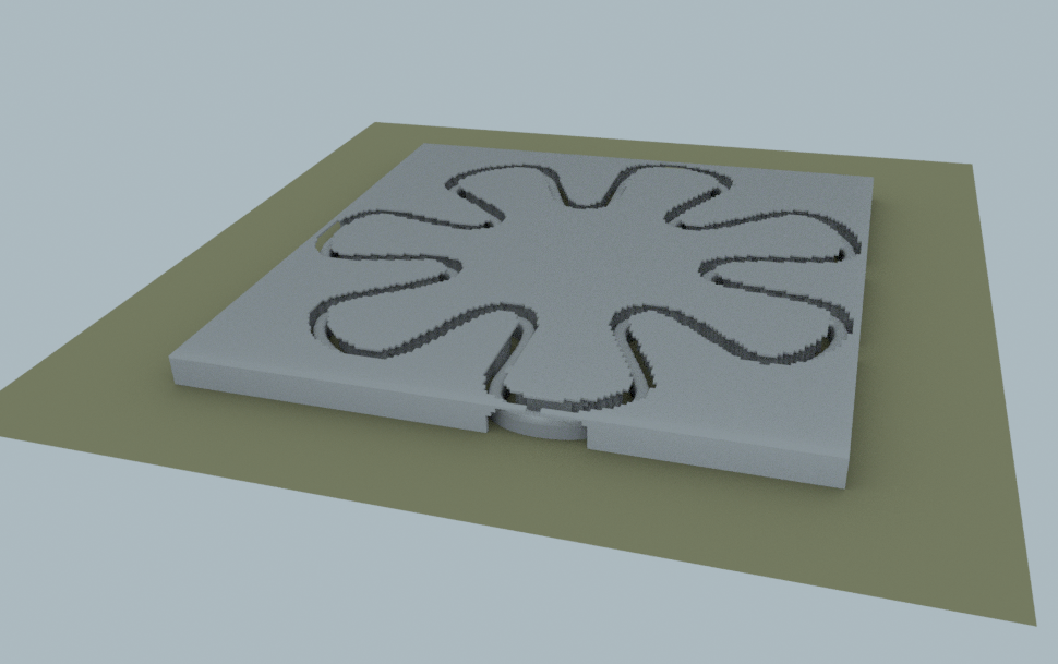

Custom SDF objects are still buggy. They create solid box outline :
SDF.orbx
(249.95 KiB) Downloaded 247 times

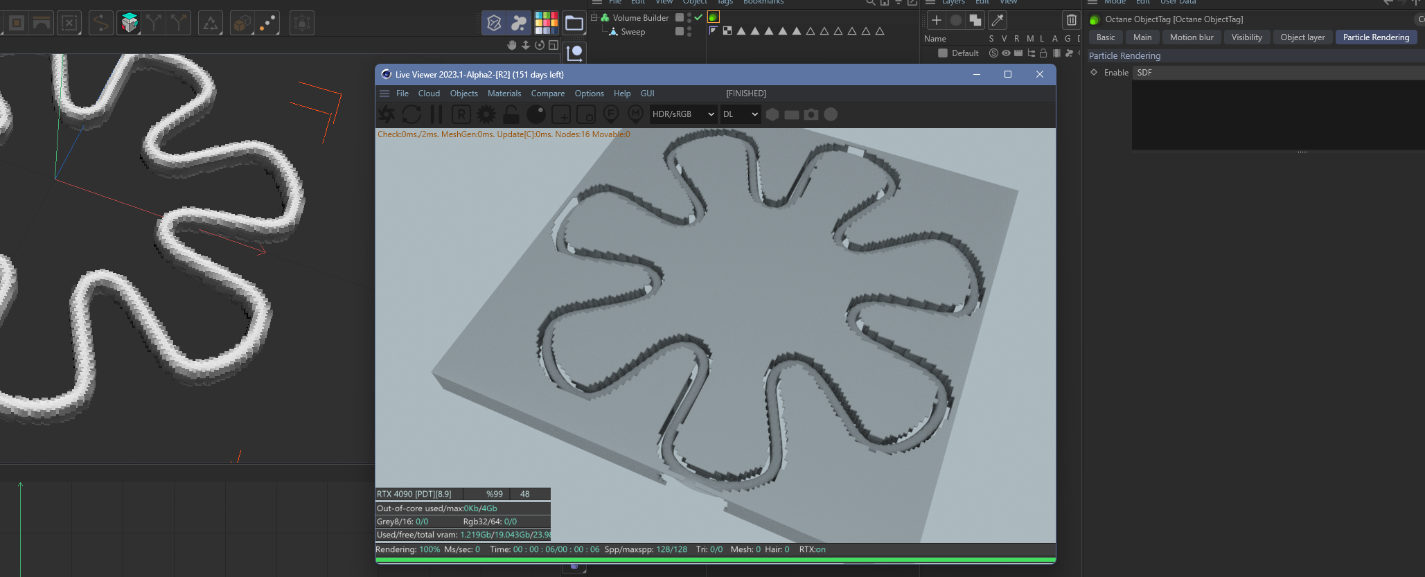

ricky_otoy wrote: Thanks. Please post or PM me a screenshot of how it looks in C4d. I opened up the volume in Blender so I have an idea, but just to confirm.
Here is how it looks in C4D :
Problem is how Octane treat exterior voxel range :
Architectural Visualizations http://www.archviz-4d.studio
roeland
Posts: 1826
The VDB file in the ORBX file has the wrong data in it, it is a fog volume instead of a signed distance field. (in technical terms, it has 0 density outside the object and positive density inside it).
