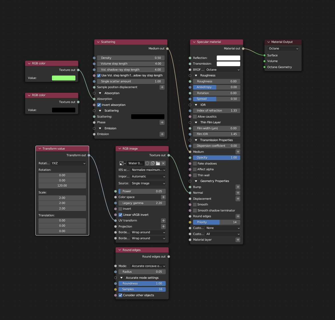

Good day all! I'm working on this scene where there are some lily pads on water and I'm noticing when the pads are submerged a little (just a few mm), the layer of water over the pads are VERY dark. This is despite setting density to 0. Perhaps this has something to do with the scattering/absorption colours?
I would love to find out how the water part can be set up correctly. I'm attaching screenshots which I think are relevant. Please let me know if you require more information. Thank you so much for checking this!

Material set up for the water. Note, I've set density to 0
Render settings. I turned off nested dielectrics because it was messing with the water

New material set up
New material set up

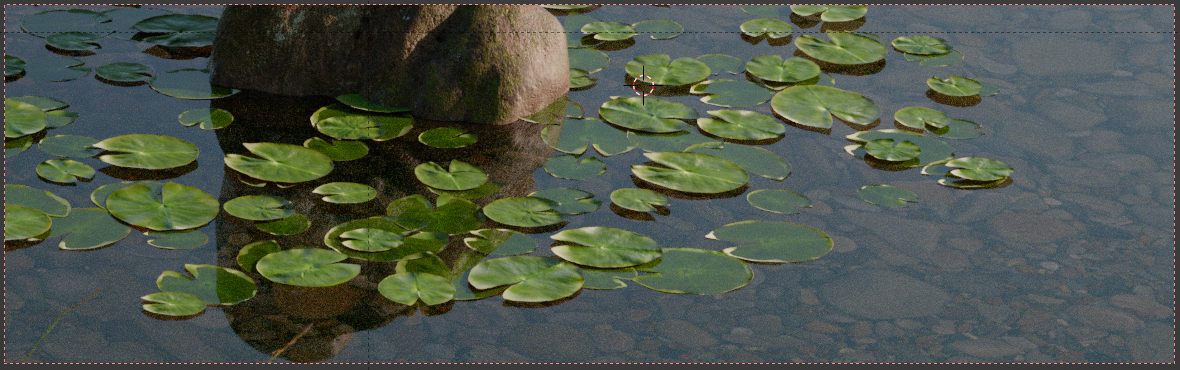

Normally, under water elements (objects, etc) have an effect of "removed-reflections". A video here or comparison below.

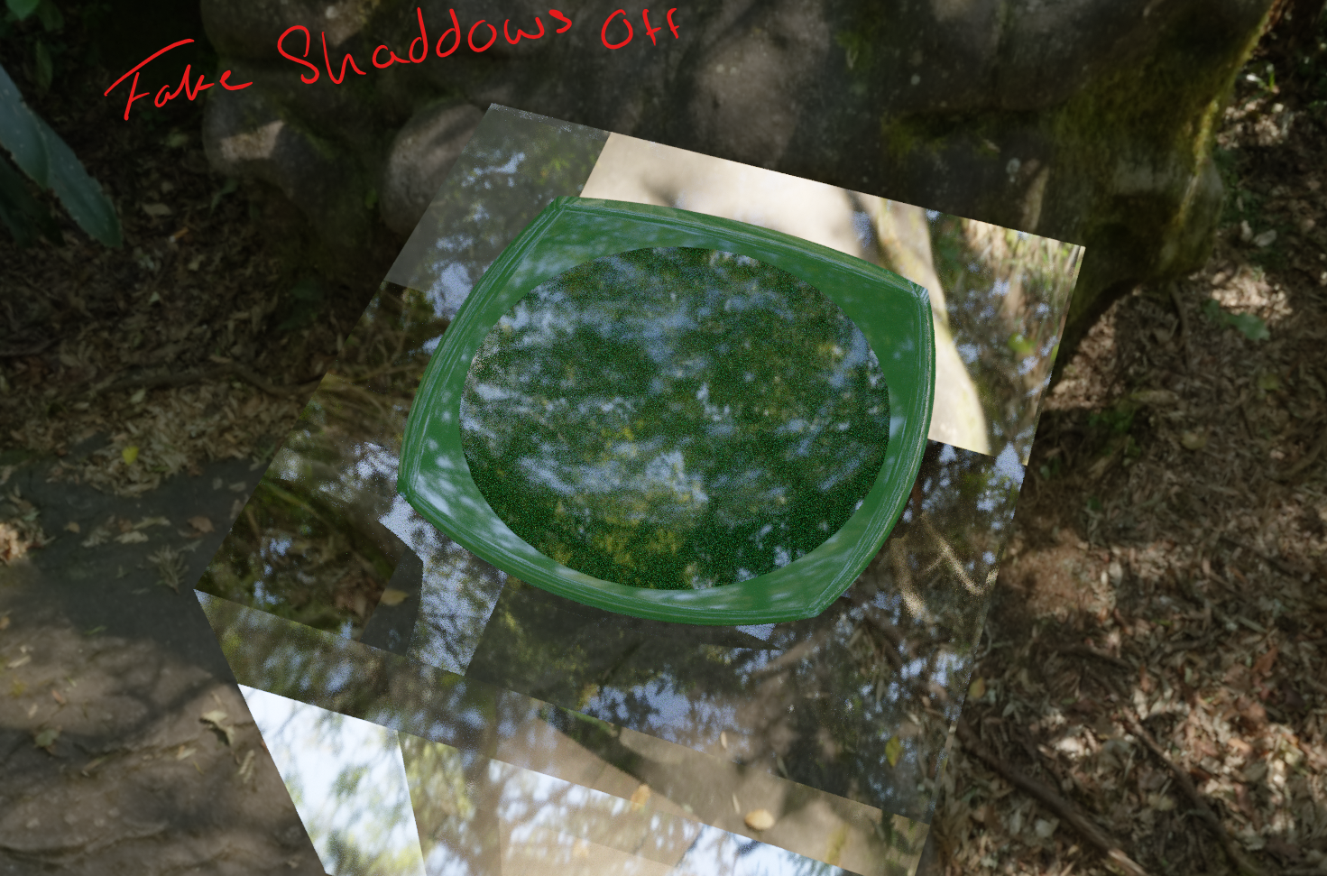

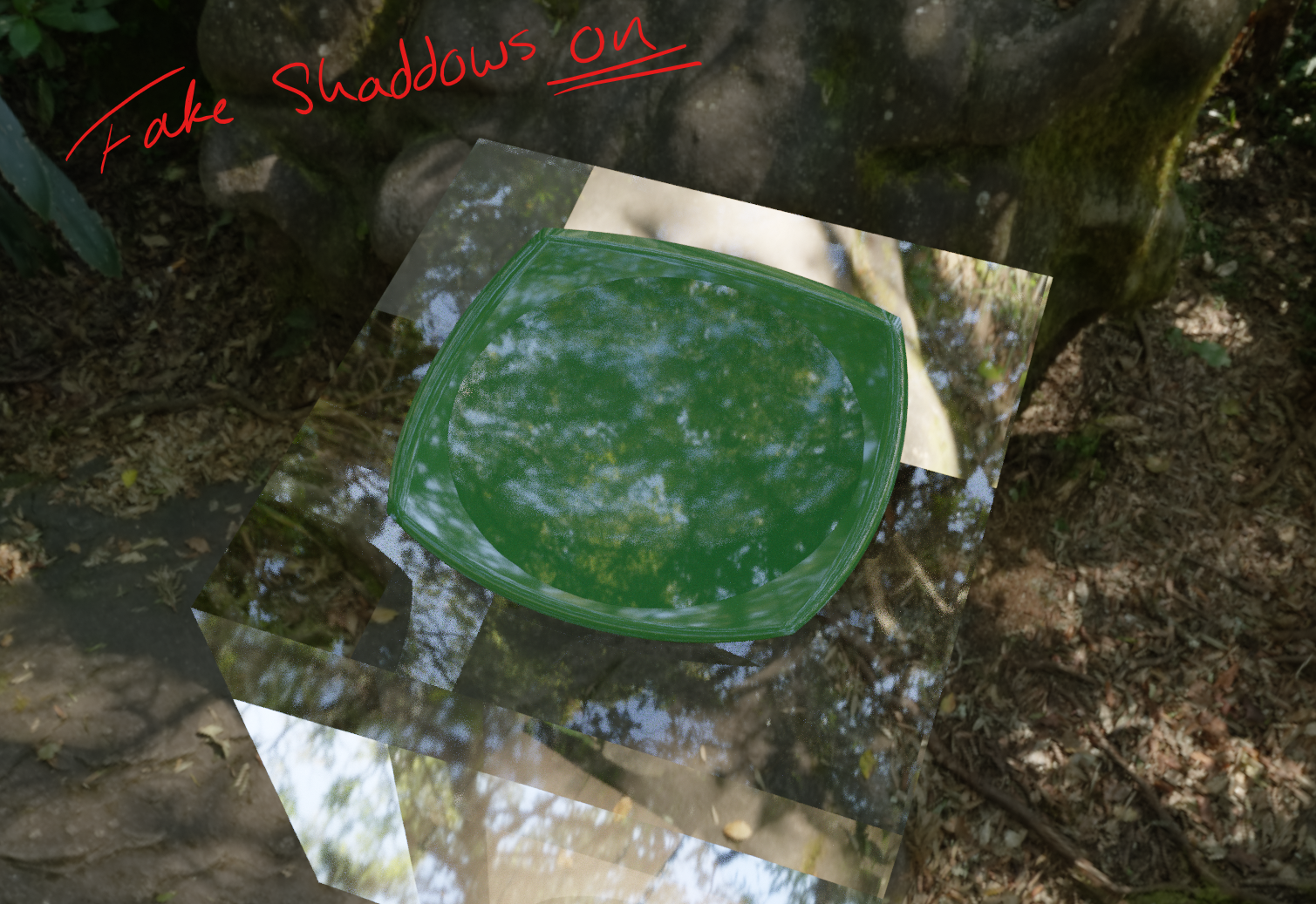

Just a few quick examples. Now, I played around with the PMC kerenl and it is still a little dark, but lighter than without it. It is certainly more physically accurate, where as the threshold between the interfaces decreases the result gets darker and as the distance gets greater it gets brighter. This makes sense, but doesn't seem like what you are after so I didn't see it as a good analog for demonstration.

I am inclined to agree it has a lot to do with the light source intensity. In fact, I am almost certain that is playing a significant roll, also why the affect of the object being deeper inside the transmissive material getting brighter seems so logical on PMC. I do still think they can quick fix this as they have it with some arm-bending with the photon tracing kernel or just enabling fake shadows
elsksa
Posts: 784
Joined: Sat Jul 24, 2021 1:06 am
+1 regarding fake shadows. It's enabled on my own linked demo.
