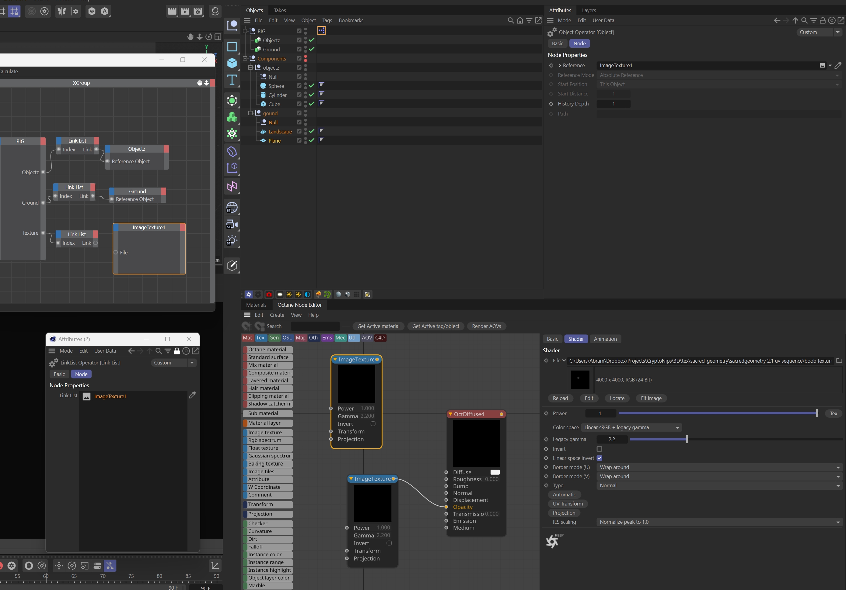

I'm a bit of an xpresso novice. I have a project where I need to have a ton of different images used as opacity maps for several different materials. I want to use xpresso to reference the folder with the image sequence and randomly assign a texture to the opacity of the material. Is this possible with xpresso? I was thinking using a linklist node, but i can't seem to get the string right.

since you are dealing with an image sequence, another solution could be to use xpresso for generating the desired file name string, like "PATH+RANDOM_NUMBER+File extension", I guess :roll:
