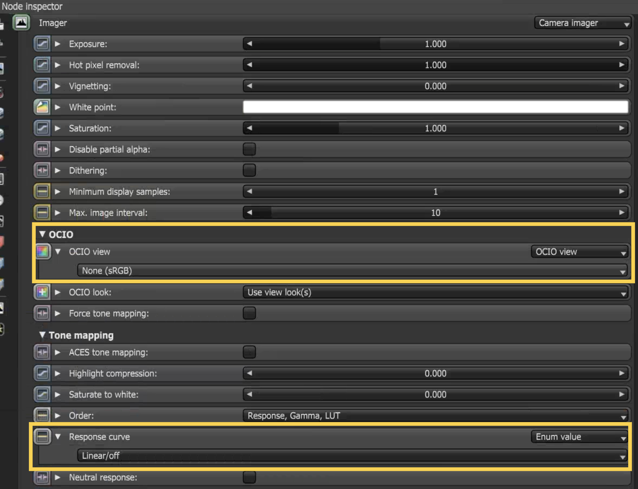

I have not tried, but, by default, the OCIO pin is set to None (sRGB) in the NT_IMAGER_CAMERA node, while the Linear color space is chosen in the Response curve popup:
So, try to only change the P_RESPONSE pin to Linear/off, in the NT_IMAGER_CAMERA node, without creating the NT_OCIO_COLOR_SPACE node.
