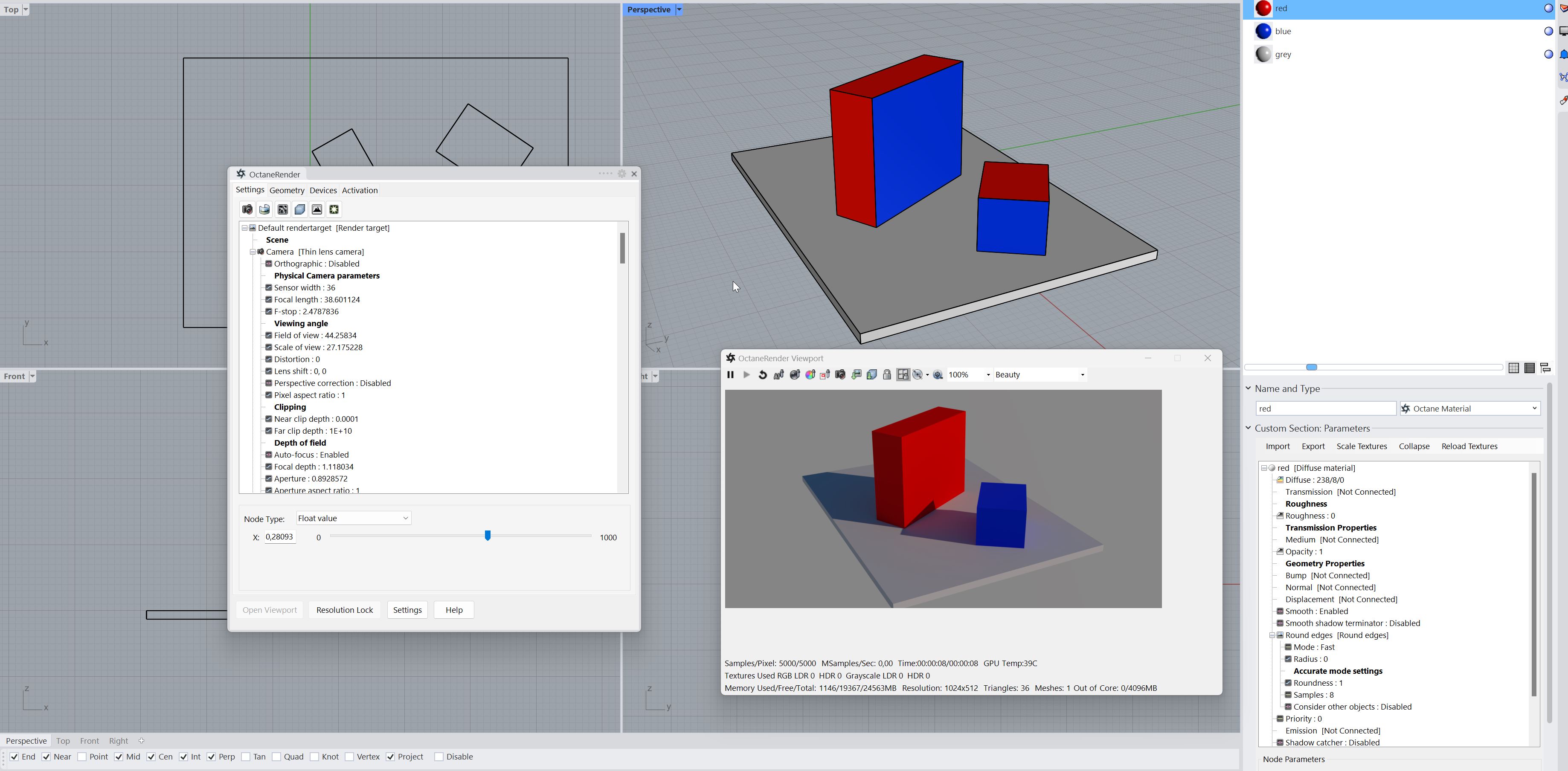

We very often have to split walls and other structures in quite painstakingly manners in order to be able to assign a different material to parts of them.
A very common example would be a wall, where we have a material for the outside like bricks and one for the inside like plaster.
It would be huge if there could be a way to assign the materials to the individual surfaces.
As you can see from the attached picture, Rhino supports this (you have to press ctrl + shift to select a surface...) however Octane just renders one color.
I attached the 3dm file for you to test.
Rhino-Octane-Material test-01.zip
(66.3 KiB) Downloaded 585 times
Please, please!

Yes - this would be great. I cannot see an obvious way to get the per-face material in the SDK, so I have asked this question in the McNeel forums. I will respond here when I know more.

Unfortunately not. Reading between the lines, it might be that this is only possible using the new Rhino change queue API (which the Octane plugin uses to identify which mesh object to reload, but doesn't actually use that API to access the vertices, polygons and materials). But I am guessing at this stage.

I have pinged the Rhino devs again in the McNeel forum. My guess on this is that it will need a rewrite of the plugin geometry loader, as I think McNeel have packed the pre-face materials into a different part of the Rhino SDK to what the Octane plugin is using. This might be a substantial amount of work. But let's see what the McNeel devs come back with.
