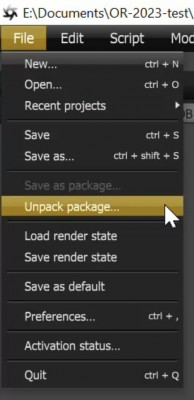

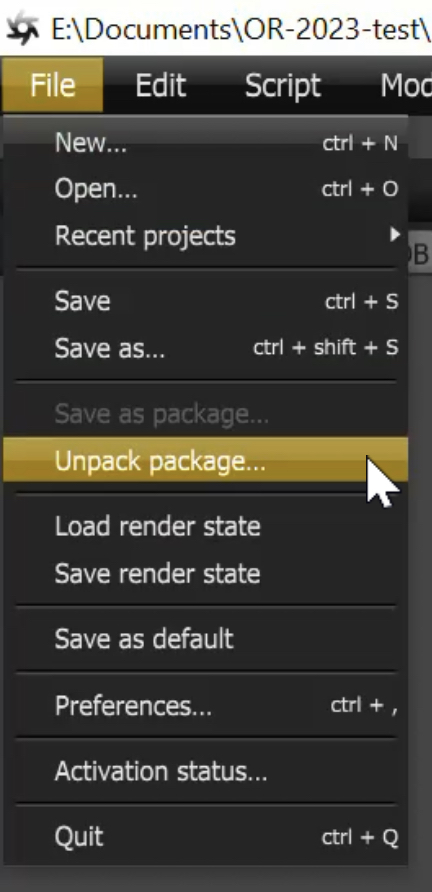

Hi. How DO you extract the texture maps from an ORBX? :)
Posts: 10637
you need to go to menu File/Unpack package command:
it will save the scene in .ocs format, with an assets folder for all geometry and textures used in the scene.

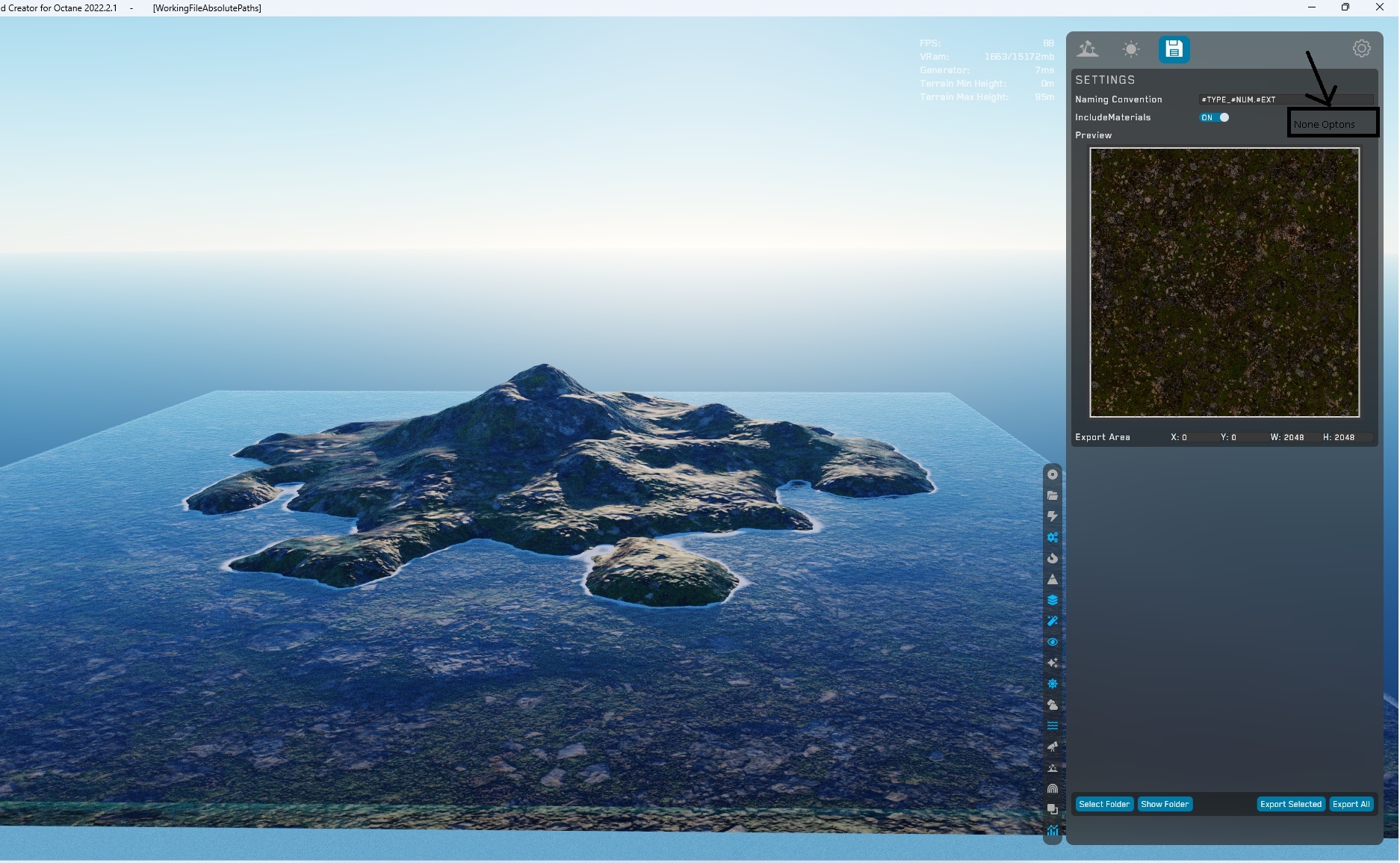

Hello, good morning
I have a problem, this version of WC don't have option to export and .obj scene and the options of materials I don't have it.
Add image like reference
Thank you if someone can help me
Posts: 10637
only Annual Octane licenses purchased during the past 2022 Black Friday sale have received one year of full WorldCreator without exporting restrictions, and three material packs.
The restricted Octane version can export only in .orbx format.
