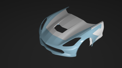

Hi. I am new to Octane (using the Blender version). I can see the render becomes blurry on the edges. I turned off "autofocus" within camera properties and lower the pixel filter to 1, but still looks really undefined on the edges.
Do you know if there are other parameters to verify to get a defined render?
Thank you (test render attached).

Turning Autofocus OFF alone doesn't reduce the blur. Make sure "Use F-Stop" is OFF and Aperture is set to 0.

Focus was off, but setting the aperture to 0 worked out. Thank you!
