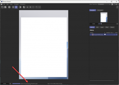

I don't know why Octane gets stuck and stops rendering Passes??

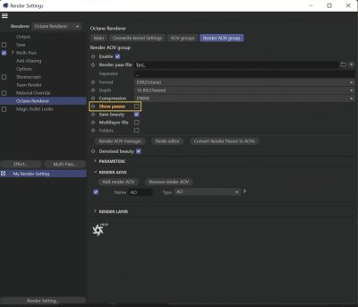

Are you working in C4D 2023.2.1?
If yes, there are some users reporting the same issue, and the workaround is to disable the Show passes option in Render Settings/OctaneRender/Render AOV group tab:
