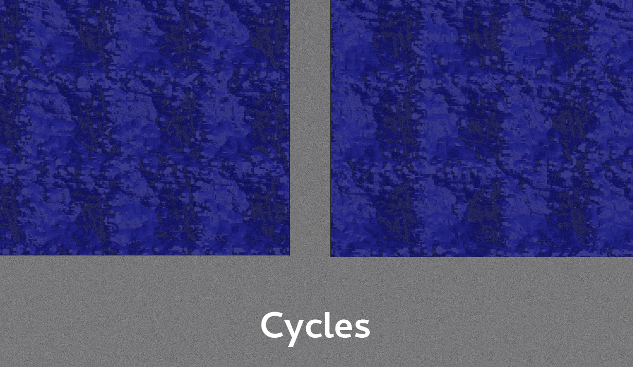

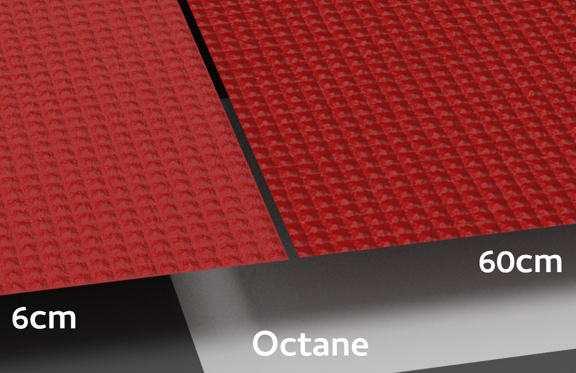

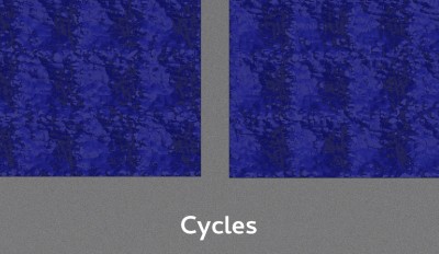

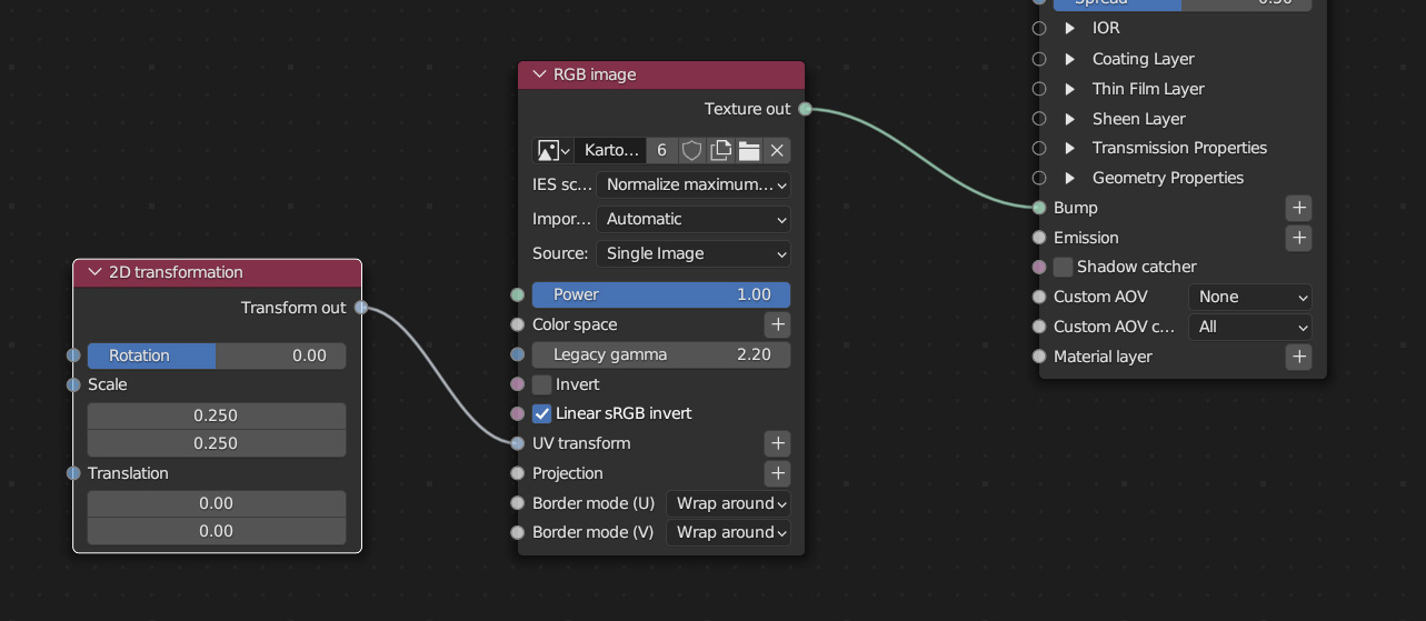

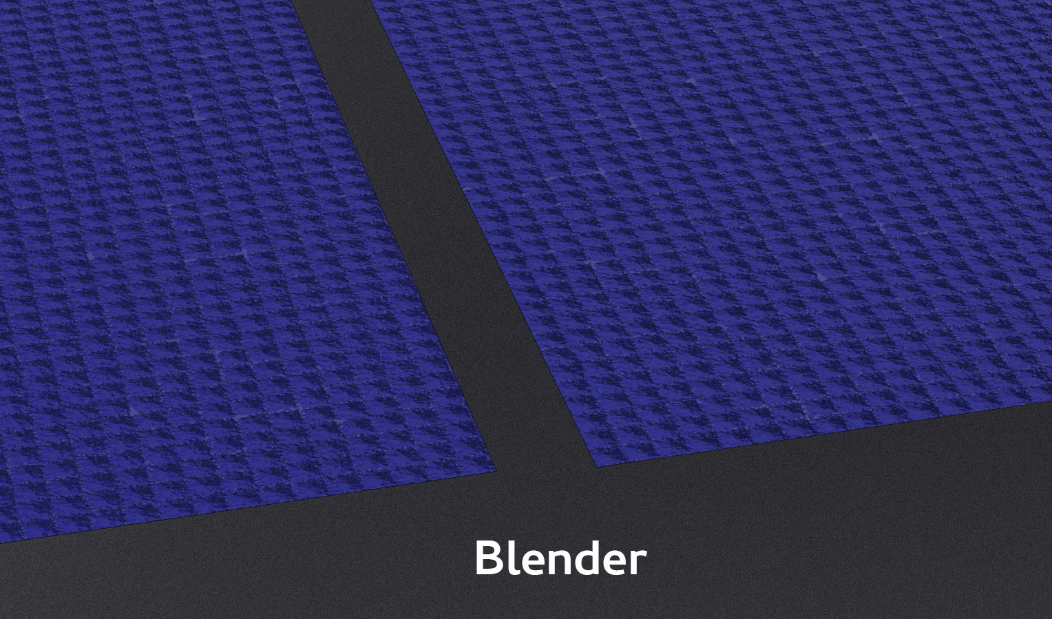

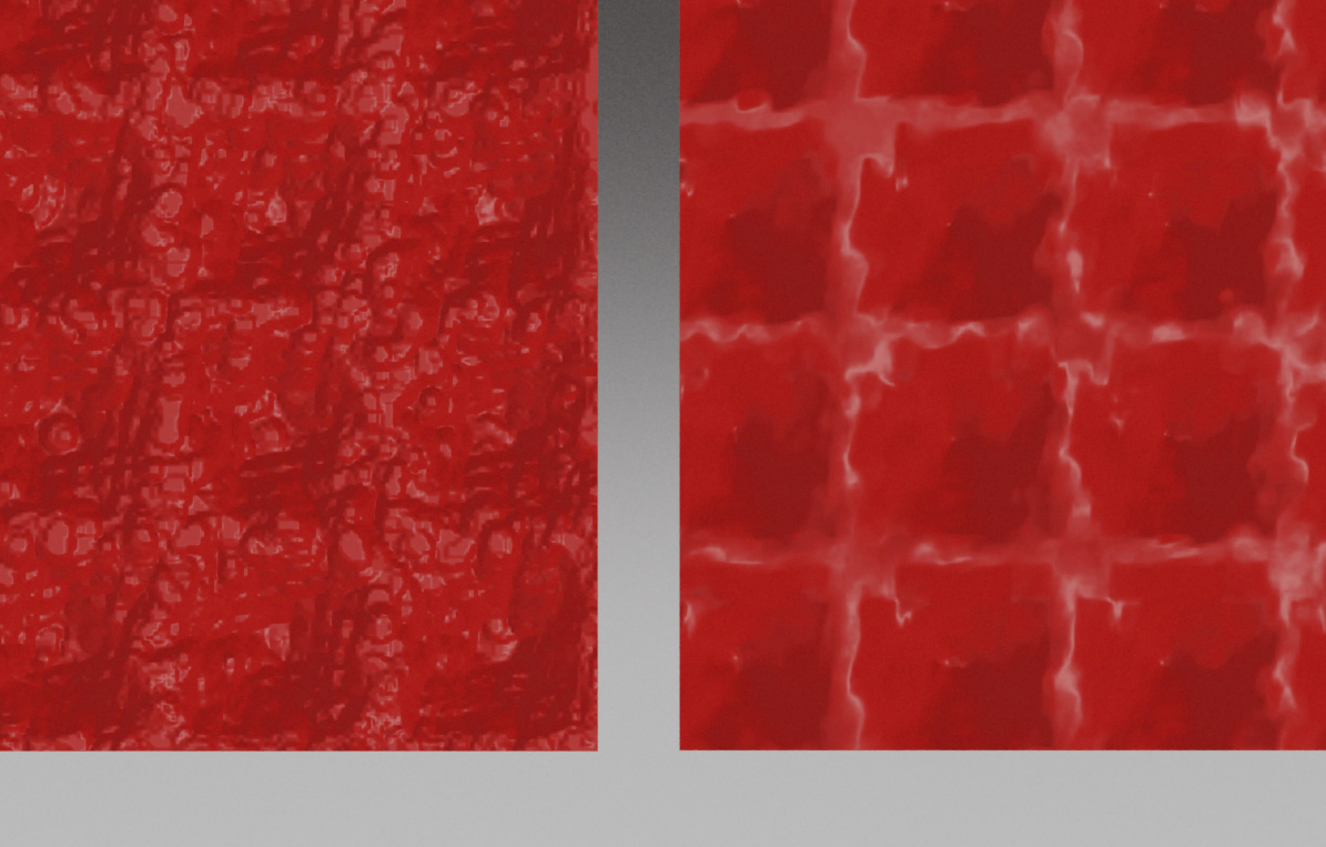

I'm just playing around with bump maps and noticed something. It seems as if the bump strength changes with the size of the object (or amount of 2D transformation). In the image below you can see a closeup of two planes. The left one has a side length of 6cm, the right one 60cm (10 times as much). They both are assigned the same material, except for the 2D Transformation that scales the size of the bump map is adjusted to match the scale. Somehow the bump map is stronger on the larger plane. What could be the reason for that? I also attached the version in Cycles, where the bump strength is the same in both cases (blue material). I've also attached the notes that I used.

One more thing. The bump map on the bigger plane also looks way less detailed.

There are no issue with auto-scaling in the scene. Both object have their scale applied, so they are not seen as "scaled" in the scene. It's about the depth and sharpness differences of the bump map when different values are used in the "Scale" section of the 2D Transformation node.

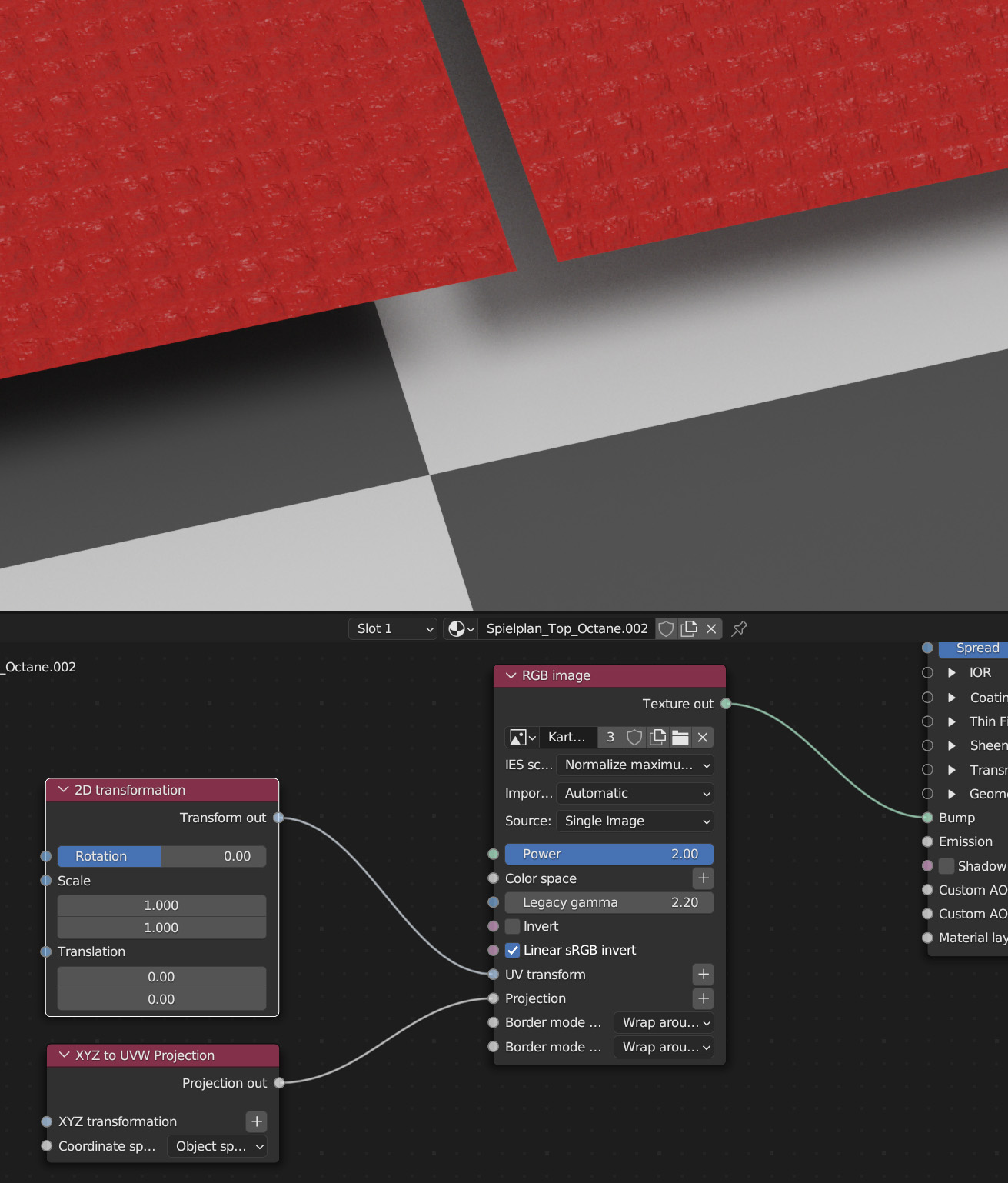

[EDIT] It seems as if adding a "XYZ to UVW Projection" node solves the issue. I can stick with the "Object Space" there and it looks fine. It's still odd though that the 2D transformation is affected in such a way.
[EDIT 2] Just found out that the "XYZ to UVW Projection" messes up my UV map. So I can't really use that workaround. So it there any other way to solve that?

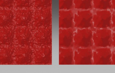

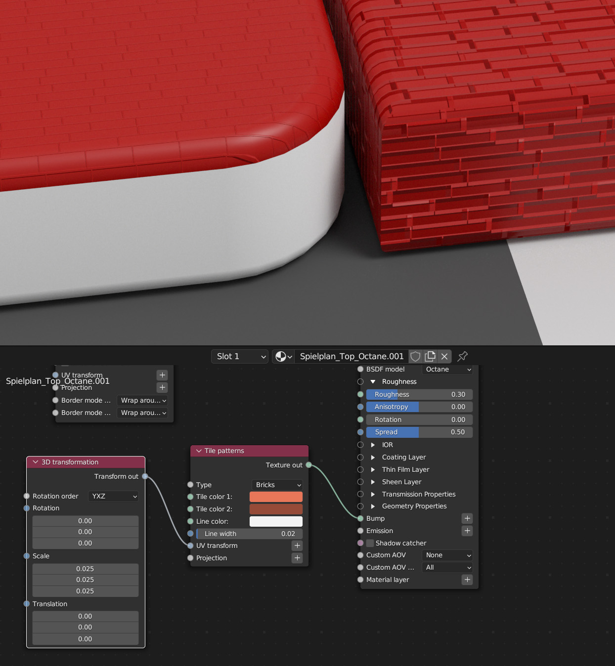

I checked if the issue appears on procedural maps as well and it does. Here's a test with two tile textures. Same texture, different 2D transformations applied. I remember having had the same issue with Luxcore, a few years back. Not sure how that is related but it's quite interesting that both renderers had this issue.

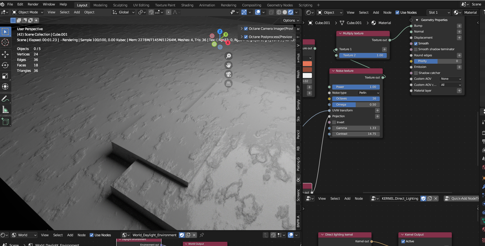

Here's a test scene. The larger cube is 10x the size of the smaller one. It uses a Transformation node to get the bump map to the same size as the small one. As you can see, the bump map on the larger cube looks quite different from the smaller one. It's more pronounced and less detailed.
http://www.argfx.at/upload/Octane_BumpTest_01.zip
Here's the same scene but it uses a procedural noise pattern. Same issue.
http://www.argfx.at/upload/Octane_BumpTest_02.zip
