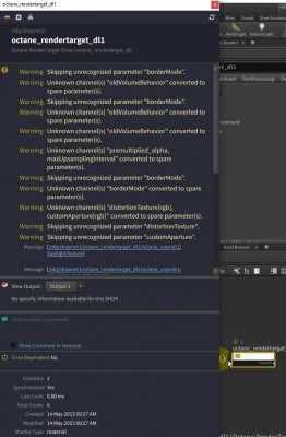

while loading it has errors like this:
Load warnings for....37-100-340-002.hip
Warning: Problem while synchronizing child node:
Warning: Skipping unrecognized parameter "borderMode".
[/obj/shopnet1/octane_rendertarget_dl1/octane_vopnet1/DaylightTexture]
Warning: Unknown channel(s) "oldVolumeBehavior" converted to spare parameter(s).
[/obj/shopnet1/octane_rendertarget_dl1/octane_vopnet1/NT_KERN_PATHTRACING1]
[/obj/shopnet1/octane_rendertarget_dl1/octane_vopnet1/EnviroTexture]
[/obj/shopnet1/octane_rendertarget_dl1/octane_vopnet1/NT_KERN_PMC1]
[/obj/shopnet1/octane_rendertarget_dl1/octane_vopnet1/NT_KERN_DIRECTLIGHTING1]
Warning: Unknown channel(s) "premultiplied_alpha, maxUpsamplingInterval" converted to spare parameter(s).
[/obj/shopnet1/octane_rendertarget_dl1/octane_vopnet1/NT_IMAGER_CAMERA1]
[/obj/shopnet1/octane_rendertarget_dl1/octane_vopnet1/CamEnviroTexture]
Warning: Unknown channel(s) "borderMode" converted to spare parameter(s).
[/obj/shopnet1/octane_rendertarget_dl1/octane_vopnet1/DL_AO_Texture]
Warning: Unknown channel(s) "distortionTexture[rgb], customAperture[rgb]" converted to spare parameter(s).
[/obj/shopnet1/octane_rendertarget_dl1/octane_vopnet1/NT_CAM_UNIVERSAL1]
Warning: Skipping unrecognized parameter "distortionTexture".
Skipping unrecognized parameter "customAperture".
[/obj/shopnet3/octane_rendertarget_dl1/octane_vopnet1/DaylightTexture]
[/obj/shopnet3/octane_rendertarget_dl1/octane_vopnet1/NT_KERN_PATHTRACING1]
[/obj/shopnet3/octane_rendertarget_dl1/octane_vopnet1/EnviroTexture]
[/obj/shopnet3/octane_rendertarget_dl1/octane_vopnet1/NT_KERN_PMC1]
[/obj/shopnet3/octane_rendertarget_dl1/octane_vopnet1/NT_KERN_DIRECTLIGHTING1]
[/obj/shopnet3/octane_rendertarget_dl1/octane_vopnet1/NT_IMAGER_CAMERA1]
[/obj/shopnet3/octane_rendertarget_dl1/octane_vopnet1/CamEnviroTexture]
[/obj/shopnet3/octane_rendertarget_dl1/octane_vopnet1/DL_AO_Texture]
[/obj/shopnet3/octane_rendertarget_dl1/octane_vopnet1/NT_CAM_UNIVERSAL1]
[/obj/Crdshopnet1/octane_rendertarget_dl1/octane_vopnet1/DaylightTexture]
[/obj/Crdshopnet1/octane_rendertarget_dl1/octane_vopnet1/NT_KERN_PATHTRACING1]
[/obj/Crdshopnet1/octane_rendertarget_dl1/octane_vopnet1/EnviroTexture]
[/obj/Crdshopnet1/octane_rendertarget_dl1/octane_vopnet1/NT_KERN_PMC1]
[/obj/Crdshopnet1/octane_rendertarget_dl1/octane_vopnet1/NT_KERN_DIRECTLIGHTING1]
[/obj/Crdshopnet1/octane_rendertarget_dl1/octane_vopnet1/NT_IMAGER_CAMERA1]
[/obj/Crdshopnet1/octane_rendertarget_dl1/octane_vopnet1/CamEnviroTexture]
[/obj/Crdshopnet1/octane_rendertarget_dl1/octane_vopnet1/DL_AO_Texture]
[/obj/Crdshopnet1/octane_rendertarget_dl1/octane_vopnet1/NT_CAM_UNIVERSAL1]

even creating a fresh render target node has errors: Attachment.

Hi, sorry for the inconvenience. It is expected that once you've saved a file using a newer version that older versions won't be able to open it any more, but it is not expected that the newer version will crash.modjtaba wrote:And there we go!
I cant get back to previous build either , because I worked 10 days using this build and previous build simply crashes hitting render button on new setups
Aside from the error messages you posted above, is the problem you're having now a crash after rendering some number of frames?
Please try setting "Multithread extraction" to "Disabled" in the Octane ROP node. There are some problems with the multithreaded code that I am working on at the moment and it would be good to rule that out to see if you have a different problem. If you still have problems with the multithreading disabled, please direct message me the file if possible.
