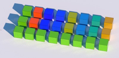

When I duplicate an object via ALT-D (Duplicate Linked) a new random color is assigned as it should be. However, when I duplicate an object via SHIFT-D (Duplicate Object), all the duplicated objects have the same color. It would be great is those duplicates have a random color as well.
Another weird thing happens when you duplicate object via SHIFT-D. Take a look at the example below. The center row has random colors for all the cubes. When I select all of them and duplicate them (SHIFT-D) at the same time, they have the same colors as the original object (boxes in the top row). However, if I duplicate each box individually, every box has the same color (bottom row). Even if I copy an orange cube, the copy will turn to green (in this example).
As you can imagine this is very confusing to work with. Somehow this logic seems reversed. I would rather expect a duplicate-linked object to keep the same color as the original and the one with is an independent duplicate object to have a different color. This would also help when you transform an array of object (via the modifier) into singular objects. They would all have different colors. Right now, they are all the same. And as it seems I would have to manually assign random color seed values to all of them, which in bigger scenes is a real problem. On top of that, every newly created object that the random color material is assigned to, has the same color. Again I would have to manually assign random seed values to object.

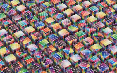

I've created a little addon (using Serpens) that randomizes the value of "Random Color Seed" for all selected objects. This will help if one wants to randomize colors for any object in the scene (not just instanced ones).
It's free and can be downloaded here ... http://www.argfx.at/upload/octane_tools_0.1.0.zip
After using the addon, you need to reload the scene. The changes are not updated in the viewport immediately. You can also move the affected objects and cancel the movement via ESC. This will also update the changed values.
Works like a charm. Those cubes were created via an array.

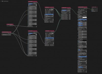

My addon basically just assigns random numbers to the "Random Color Seed" value of the selected objects. Once that is done, you can use the "Random Color Texture" node in the Material Editor to drive certain values. As for the random rotations, I have to use an OSL node that I downloaded from the Silverwing repository. I wish it was easier, but that's how we need to work around that for now.
Silverwing Repository ... http://www.silverwing-vfx.de/free_stuff.html
Here's an example for the material node tree.

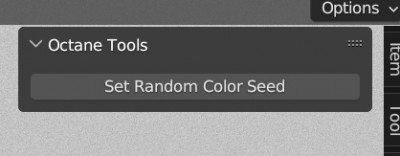

After installing, you should have a button in the flyout menu on the right. Like that ...
After that just select all the objects that you want to randomize and click the button of the addon. You will not see the changes immediately. Not sure how to refresh the scene from within the script. But just start to move the objects by hitting "G" and abort it by hitting "ESC". After that the objects should refresh and the randomization should be visible.
Hope that helps.
