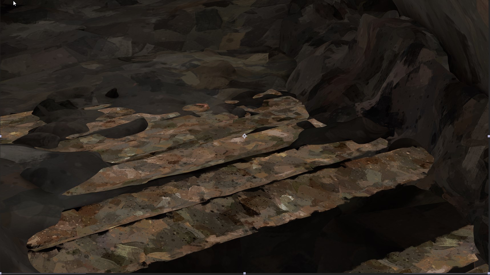

I'm currently working on a project where I only need the Diffuse Filter and some other AOVs and I discovered the following:
When working in ACES 2065-1, the Diffuse Filter doesn't match what I see in the LV, it needs a massive gamma correction. This seems to be scene related because I tested the same settings with another scene (completely different lighting scenario) and the Diff F was just slightly off. The main beauty layer looks perfect. My setup:

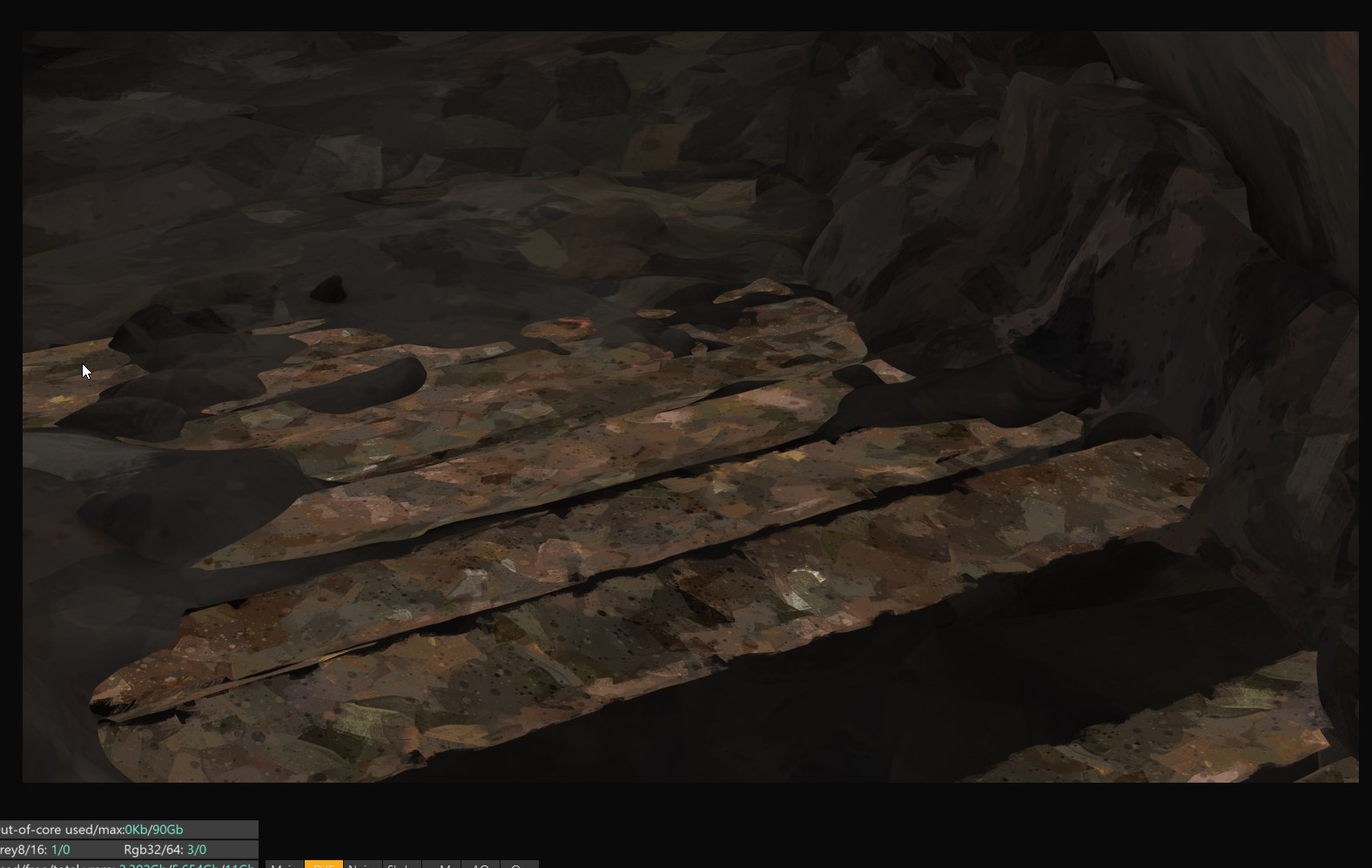

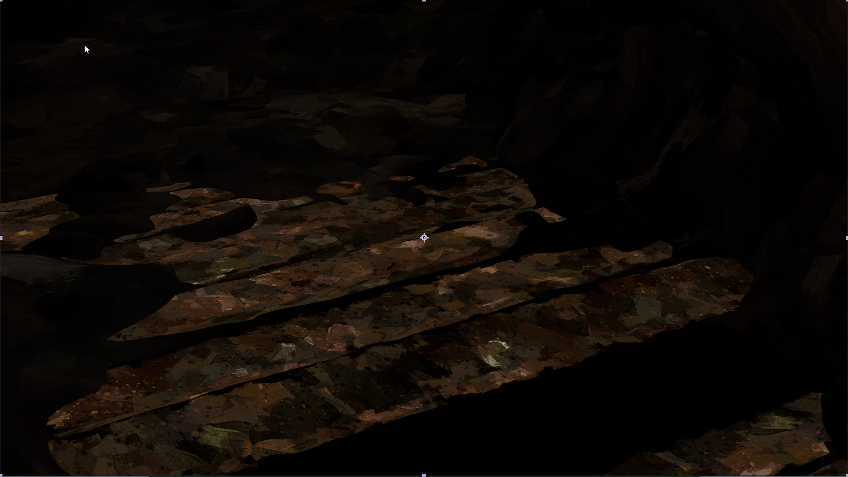

Please see the attached images.
1) Gamma correction from 1 to 1.55
2) what the LV shows
3) what AE shows right after import
Adjustig the Gamma is not a big deal right now, but a) it would be nice to rely on the LV to get what you see and b) it seems the gamma correction is scene dependent.
Am I doing something wrong or ist it an unwanted behaviour of Octane?
