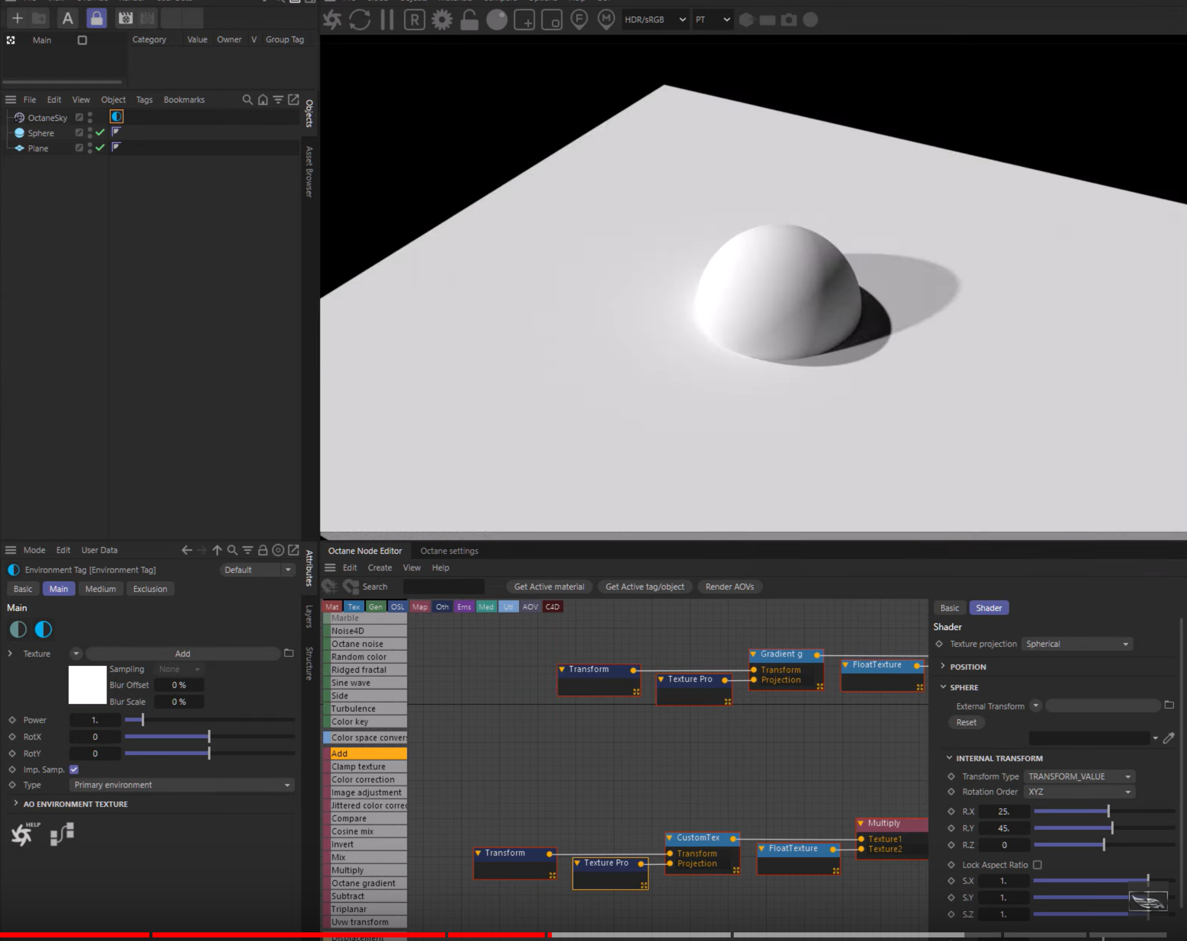

I recently saw this video from Silverwing which uses Octane Sky to add multiple distant/effectively parallel lights using gradient nodes. It's a little cumbersome to set up, compared to just using distant spotlights, but it's also quite elegant in its own way. I was thinking it would be fairly easy to link the Transform controls to appropriate geometry/curves for more direct, intuitive aiming in world space. You could build a Sky rig with half a dozen pre-built directional lights on it and keep it in your toolbox.

elsksa wrote:Haven't seen the video yet but it reminds me of this technique from this page
It's a similar idea, but using layered gradient nodes in a procedurally generated HDR environment texture to generate multiple light sources. One advantage over just using the Sun light in a black sky is that these lights work perfectly well when rotated below the horizon.
Multiple distant lights in one Sky object.
