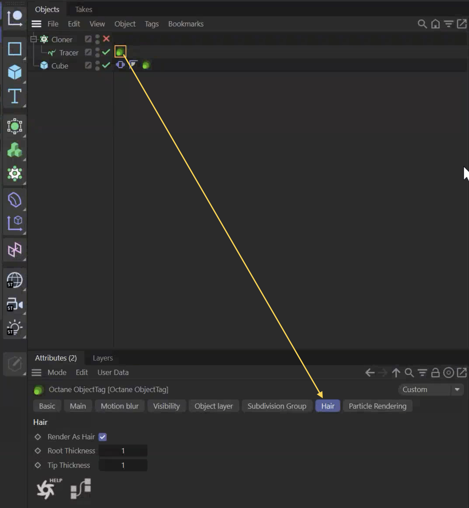

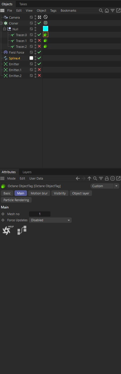

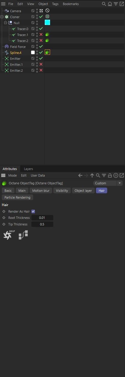

If I place octane tag on a spline I get 'Hair' properties tab with option to setup 'render as hair' but If I place the tag on 'tracer' this option is gone. What is interesting if I first place it on spline and set up my 'render as hair' properties and then move this tag to a tracer even though it is gone from preview it keeps all it properties intact and it is possible to see result on render. Is this intended to work like this?

the issue is caused by the MoGraph Cloner, if you temporarily disable it, and select the Octane Object tag, the Hair tab will be visible again:
