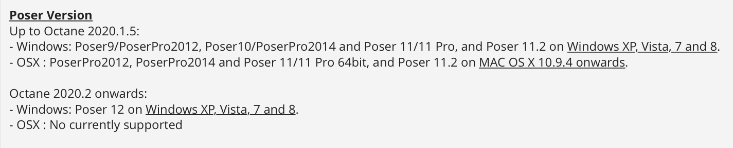

I am trying to see if Otoy would work for me. I have both Poser 11 and 12 installed but work primarily in Poser 11. For reasons best left unsaid, I would like to continue working in Poser 11. I installed Otoy in Poser 11 and upon, opening Poser 11, I got an add-on error. (Bad magic number) meaning that it is not for Poser 11. Have it now in Poser 12 but would like to use the Otoy for Poser 11. Is there a way for me to download an early trial version of Otoy for Poser 11? ;)
Thanks in advance
Posts: 10595
sorry, not a Poser user, but I had a look at OTOY Poser forum section, and it seems that you need to go back to OctaneRender® 2020.1.15, to be able to work with Poser 11:
Here is the link to Poser 2020.1.5 Demo version:
https://render.otoy.com/plugindownloads ... 3_DEMO.exe
