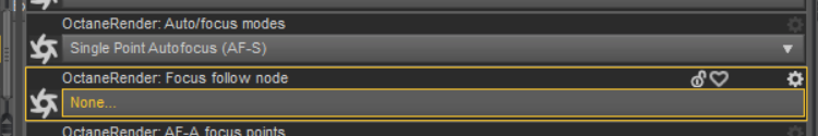

  • Added a new property to camera nodes that makes it easier to choose a node to follow with the focus
    Note that if you load a scene with existing cameras, this (and other) new properties will appear at the very bottom of the list of properties instead of in the most logical place. Creating a new camera should show the correct ordering of properties.
  • Fixed the calculation of focal depth when following a node that was not in the center of the camera film
  • Fixed focus follows node mode to actually update the focal depth when the followed node moves

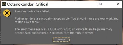

I get bluescreen with this build and i get cuda errors.
download/file.php?mode=view&id=90965
also with the shaders being in the scene list now it does not save with the scene if changed and does not save if you save daz matherials

Hi, thanks for testing!
The blue screen and CUDA errors are most unexpected (and shouldn't be caused by changes in the plugin). Just to confirm, are these problems with a scene that works without issue in the stable version of the plugin (2022.1.1_212)?
Can you say a bit more about what "if you save daz materials" means? Are you saving a subset of the scene?

I personally haven't had any issues with Octane materials saving in a scene (haven't tried a material preset though).
I have been having blue screens on and off most of this year though, with the errors of TDR Delay and PDC Watchdog mostly, but maybe others. At least some of them where caused by the recent (Feb? I think) Photoshop major version upgrade and bugs/compatibility issues in the nVidia studio driver, but that wasn't the only cause.
I've been upgrading to the latest nVidia studio drivers almost as soon as they've come out and while it's still happening every now and again, it's a lot better than a few a day I was getting sometimes.
However, after the Photoshop drivers bugs were fixed, a 100% of my blue screens have been when using Daz Studio and the plugin, with them mostly seeming to happen when the viewport hits 1000/1000 samples (whatever max samples is set to) and then trying to move the camera only to find the viewport render wont restart and after few seconds a blue screen happens.
I had been assuming it was a hardware fault on my side, but if others have been getting them maybe it isn't.

yea i just got a new pc and it seems BSOD for really fast modern pcs is a norm for windows i have random once and almost never the same.
I had to use DDU for uninstalling my drivers to get back to rendering.
