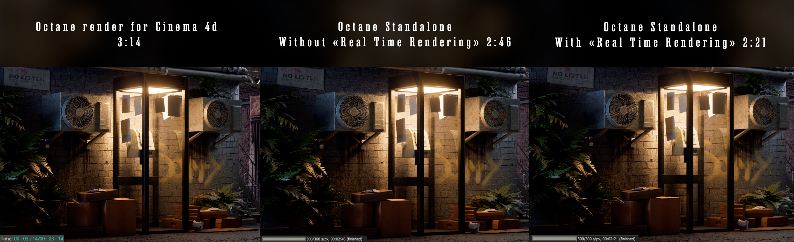

Recently I decided to test the octane standalone and compare the speed of the plugin and the standalone version, as a result of my tests I found the "Real Time Rendering" function in the octane standalone. It increases vram consumption, but it also increases rendering speed, it is independent of parallel samples parameter which works great, can you tell me about how this function works and if it is possible to enable it in octane for cinema 4d (maybe there is some analogue of this function in the plugin that I don't know about).
The results of my tests for those who are interested ↓

Standalone Real Time mode is not completed, and it will be finished in 2023.1 SDK.
For now, it only moves the tone mapping to GPU, and a lot of features are not supported:
  • Noise pass
  • Denoised passes
  • Cryptomatte passes
  • Upsampler
  • Adaptive sampling
  • Export deep image
  • Display color management
  • Multi GPUs rendering
  • Network Rendering
So, better to wait for next SDK.

At the moment Standalone is 25% faster than C4D plugin so when SDK will be finished it will be 50-75% faster than plugin right ? I think that Amaterasu asked about speed difference not current SDK stage...

Right, 25% speed increase in Standalone compared to plugin version is not important if you work with small images. But if you going to render four hi-res images for print and one of them is rendering one hour there is big difference - 4h vs 3h right ? So the question is - why plugin version is that much slower than standalone ?

Sorry, could you share an example scene that shows 25% difference in speed between c4doctane and Standalone?

Amaterasu, can you send this scene to Otoy for compare ?
166 seconds vs 194 seconds is exactly 25% if nothing has changed in recent years.

Real time rendering is not accelerating the render speed. It's more like having faster viewport refreshes as I can know. As providing direct memory transfer between GPU and CPU. Less time to display images, because transferring the render buffering is taking more time without it. Adding this support will be examined because I don't know that C4D will allow it or not.

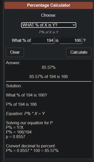

I'm confused how you are getting 25% from these 2 render times. Can you explain your formula?
I searched google for some different formulas, and percentage increase/decrease is calculated like this:
If Standalone is the original render (166s), I'd calculate C4Ds render time percentage increase with:
((194-166) / 166) * 100 = 16.87%
or if C4D is the original render (194s), then Standalone's render time percentage decrease is:
((166-194) / 194) * 100 = -14.43%
