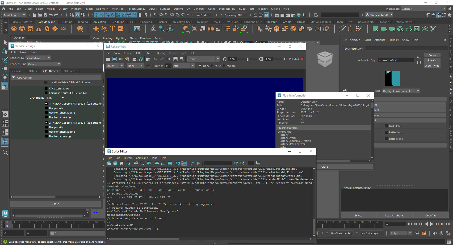

hi,
yes, gpus are enabled.
here is a screenshot how it looks like...
Render View shows only default "blue" color and no rendering starting...
No Errors in script editor...

nospitters wrote:hi,
Ah thanks for the screenshot.
Please also enable the "use for tonemapping" atleast on one of the GPU!

thx...
that was it. now it works...
