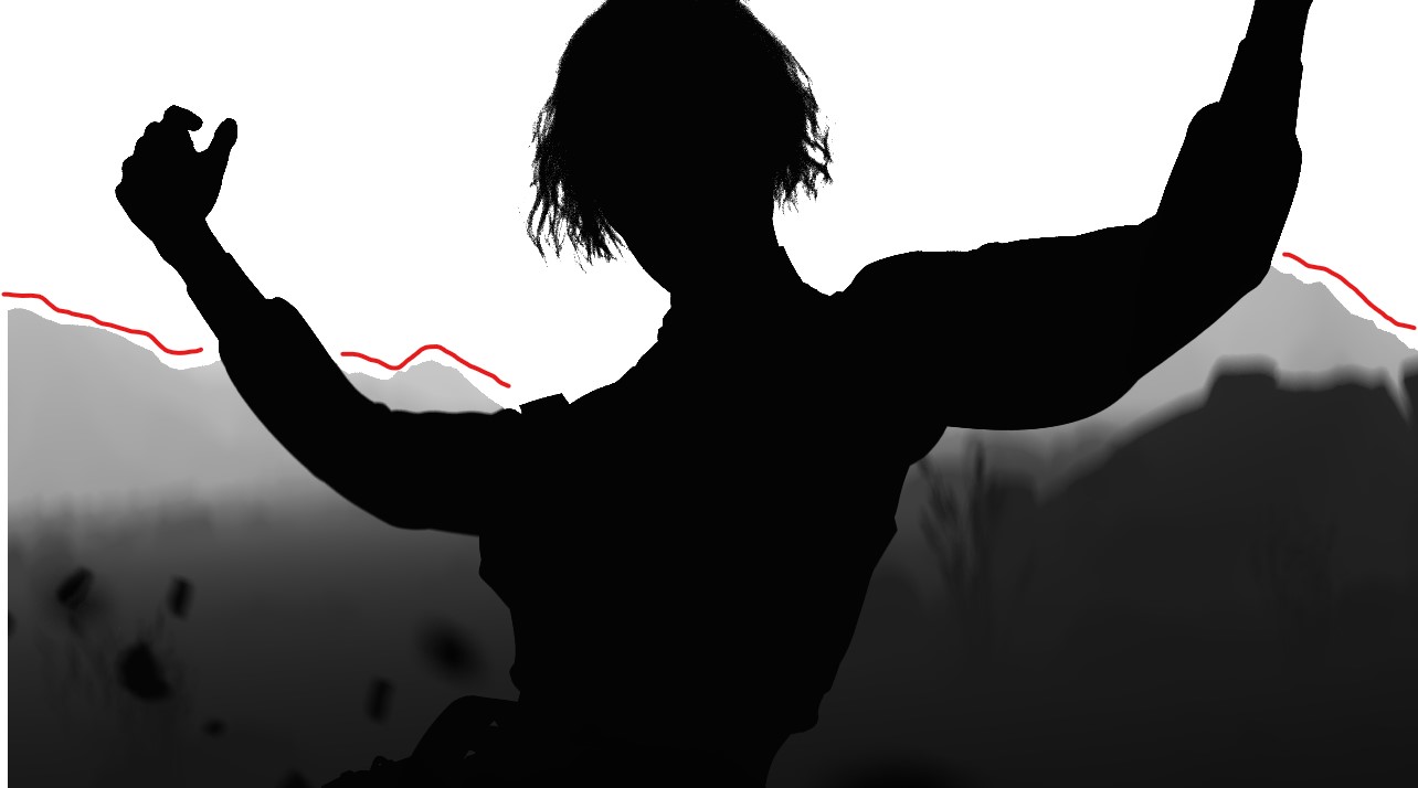

I rendered a scene that contains 'in render' camera depth of field. I wanted to add a bit of atmosphere in post so I enabled Zdepth pass.
If you see the image attached you can see that my Zdepth contains the DOF informations except for the background object under the red line. In my scene I have a plane far in the background (white part in the Zdepth) so there is no empty BG or alpha.
Why would the element under my red line not be blurred as the other things in my scene?
Thank you

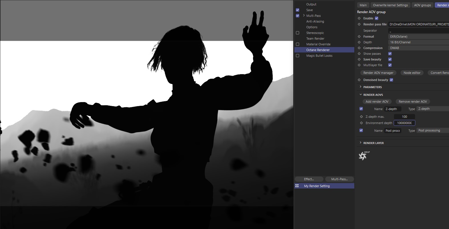

Try adjusting the range you are applying to the ZDepth AOV, available in Render Settings > Octane Renderer > Render AOV Group > Render AOVs turndown > Z-Depth. You have the Z Depth Max value and the Environment Depth value. I suspect the Environment Depth value is the one you need to adjust for your scene.

Thank you all for your responses.
I have done some test.

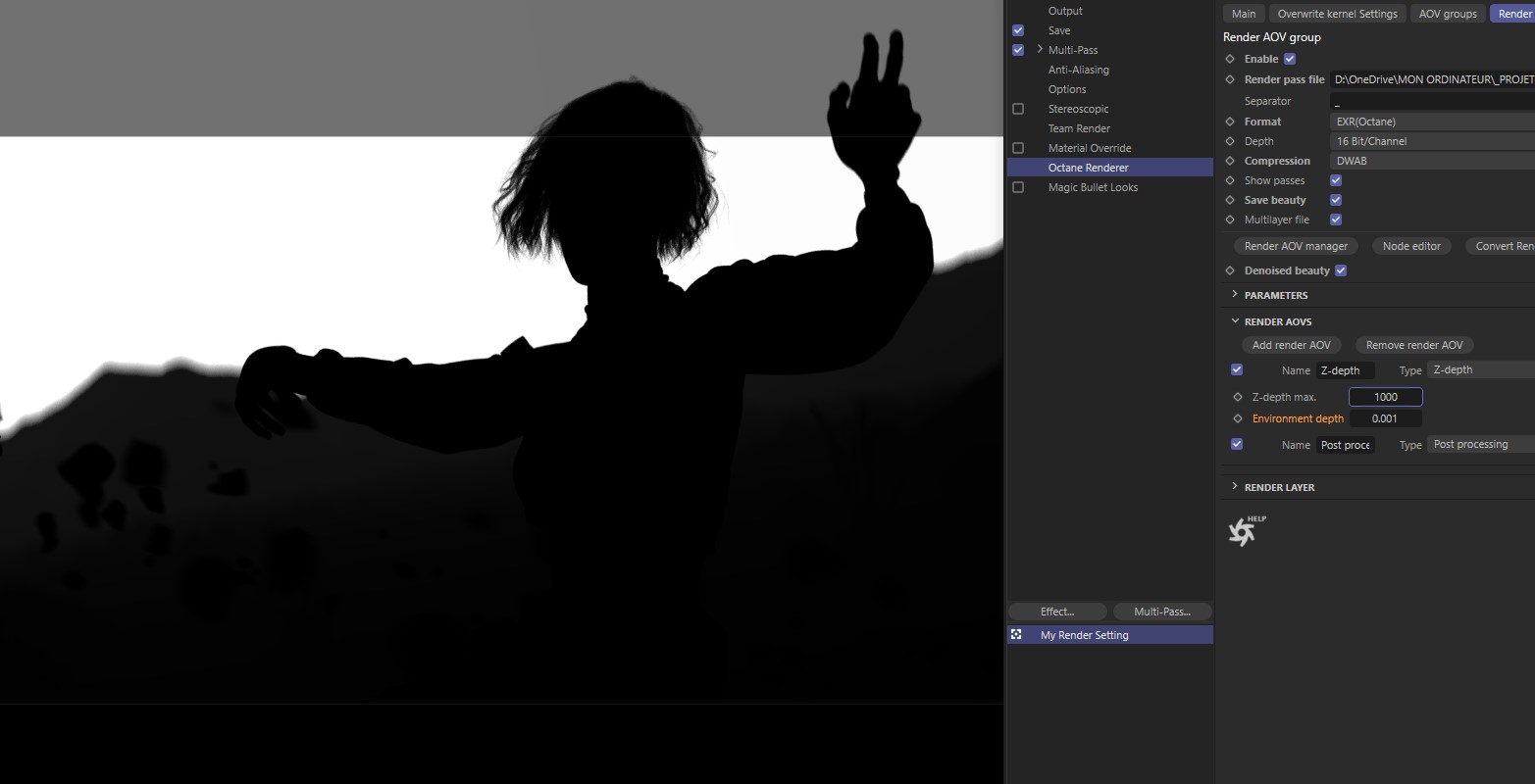

If you look at the 2 images attached you will see that the environment depth setting does absolutely nothing (or there is something that I don't understand?).
The only way I could get the DOF to work on that background element is by increasing the z-depth max to 1000. But I am getting much less contrast on the first half of the scene. Maybe it is normal?
