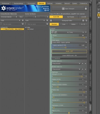

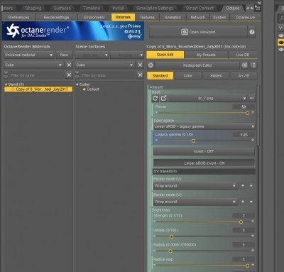

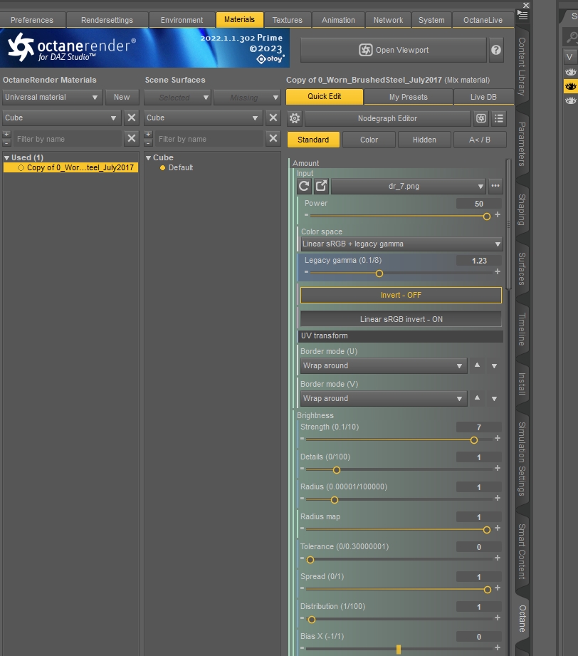

I don't know if this is a fault with Octane or DAZ Studio, but since it only happens when I use the material picker from the Octane Render Viewport, I'm guessing it may be Octance.
So... what happens is...
- The "Tool" tabs in Daz Studio are placed to the right. (see the first image attached)
- I open the Octane Render Viewport, select the "Material Picker" icon, and select a surface in the scene. (see the second image attached)
- Upon picking the surface in the Viewport, the DAZ Studio tabs jump to the top automatically. (see the third image attached)
The only way to get the DAZ tabs back to the right is by toggling "Window" "Workspace" "Orient tabs Along Top" ... on and off
This only occurs when using the Material Picker icon from the Octane Render Viewport.

RGUS wrote:Hi,
I can reproduce this, it's really weird. It only happens when the pane group containing the plugin's pane is undocked. I have no idea what I can do about this - all the plugin is doing is requesting that its pane be shown. It looks like a bug in DAZ Studio at the moment.
RGUS wrote: The only way to get the DAZ tabs back to the right is by toggling "Window" "Workspace" "Orient tabs Along Top" ... on and off
I found I could also select Pane Group -> Tabs Right again (even though it is already checked).
