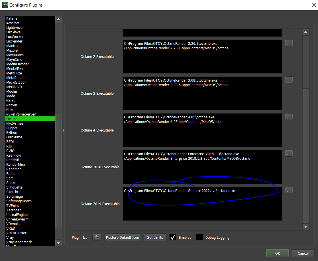

Hey beautiful render people,
I'm currently trying to set up Octane for our renderfarm that is currently running with Thinkbox Deadline 10.1
First thing that I noticed is, that strangly the plugin-paths are preset up only up to Octane 2019, I just changed the path to the current version 2022 to ge the submission working (see screenshot). The paths are also linked to Enterprise lic, I have a Studio+, could that be an issue?
Anyway, the plugin is found now but the worker cannot start the rendering, log says:
2023-04-13 20:44:44: 0: STDOUT: [string "octane_render_utils_lua"]:200: bad argument #3 to 'gsub' (string/function/table expected) (line: 200)
2023-04-13 20:44:44: 0: STDOUT: Stopped logging on 13.04.23 20:44:44
2023-04-13 20:44:45: 0: INFO: Process exit code: 100
Any idea what the issue is?

Hi jxrgen,
Thanks for the post.
The Plugin path/version and the .lua script error must be updated from the AWS side.
Please replace this .lua file from the post to fix the "200 bad argument error"
viewtopic.php?p=403251#p403251
cheers
