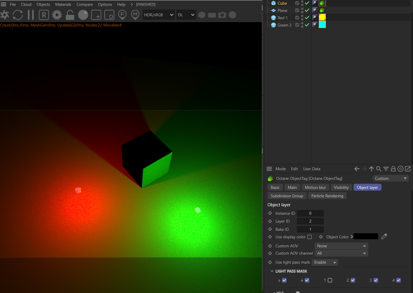

If I understand correctly, you need the "Light Pass Mask" function in the Octane Object tag. Enable "Use Light Pass Mark" at the bottom of the Object Layer tab (it has a typo in the label, should be MASK), then use the check boxes to choose which light sets you want to illuminate the object.
In this example, the cube has light pass 1, the red light, turned off, but light pass 2, the green light, turned on.
Light Exclusion with Light IDs.
