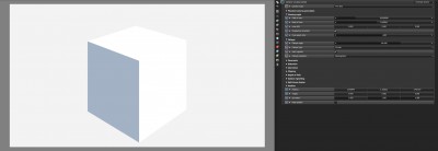

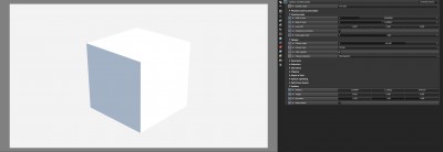

Perspective correction in universal camera doesn't do anything.
Perspective correction enabled
Perspective correction disabled
Win 10 64bit // GTX 4090 + GTX 3090 // 5900x // 64GB // SideFX Houdini // C4D
juanjgon
Posts: 8867
Location: Spain
galleon27 wrote: Perspective correction in universal camera doesn't do anything.
Hmm, how this option works in Standalone? From the tooltip, it works if the camera up vector is vertical.
-Juanjo

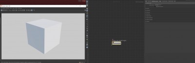

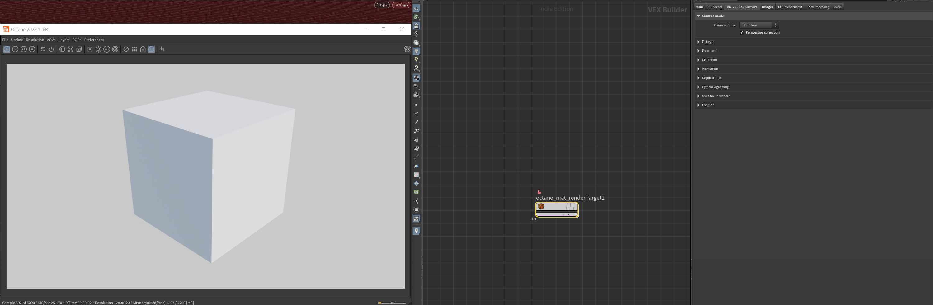

-Juanjo
Here's how it works in standalone.
perspective_correction.zip
ocs & hip files
(94.18 KiB) Downloaded 181 times
