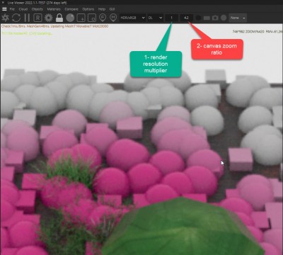

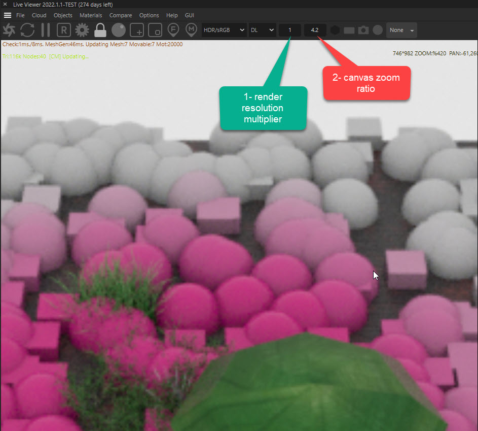

I'm not sure what's the question but see image. You can zoom/pan render buffer without changing the resolution. Nr.2 is parameter of scaling. Mouse wheel is for ZOOM, MMB is for pan.
ALT+mouse is for ROTATE/PAN/ZOOM
CTRL+LMB=copy material
CTRL+RMB=paste material
SHIFT+LMB=select object
