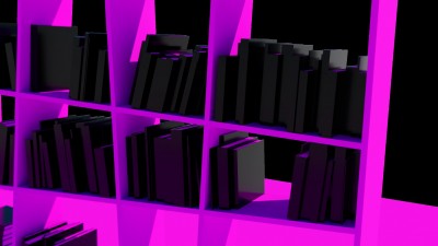

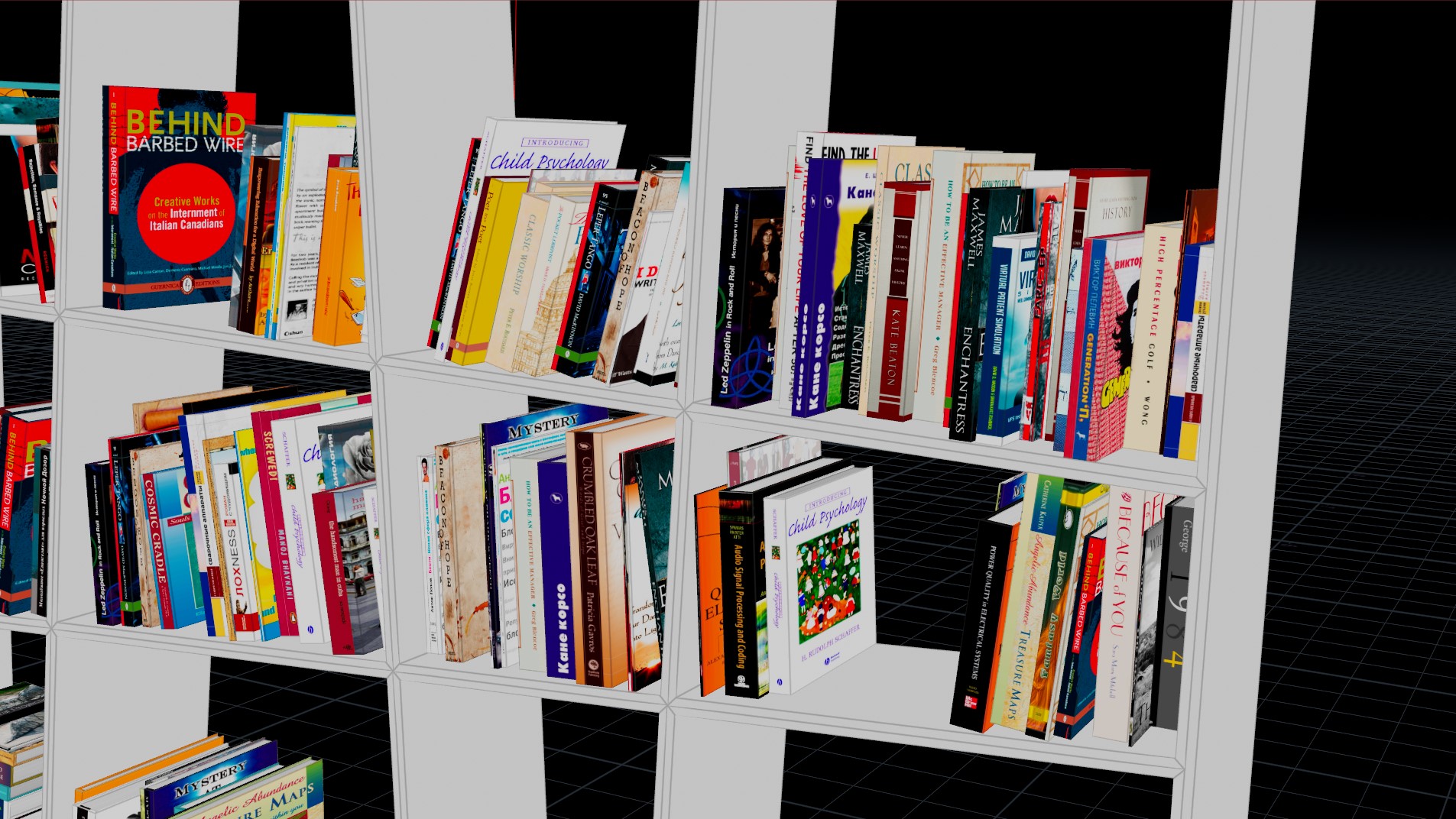

ran into an issue and can't really figure out what's going on. I have a scene originally set up for Mantra (Principled Shader) and I'm trying to reference base color texture paths from the Principled Shader using 'chs("texture")'.
Works fine for OGL preview in viewport, textures show up correctly, works as expected. However when rendering textures don't show up at all, replaced by black base color.
What did I miss? Any ideas welcome, thanks guys!

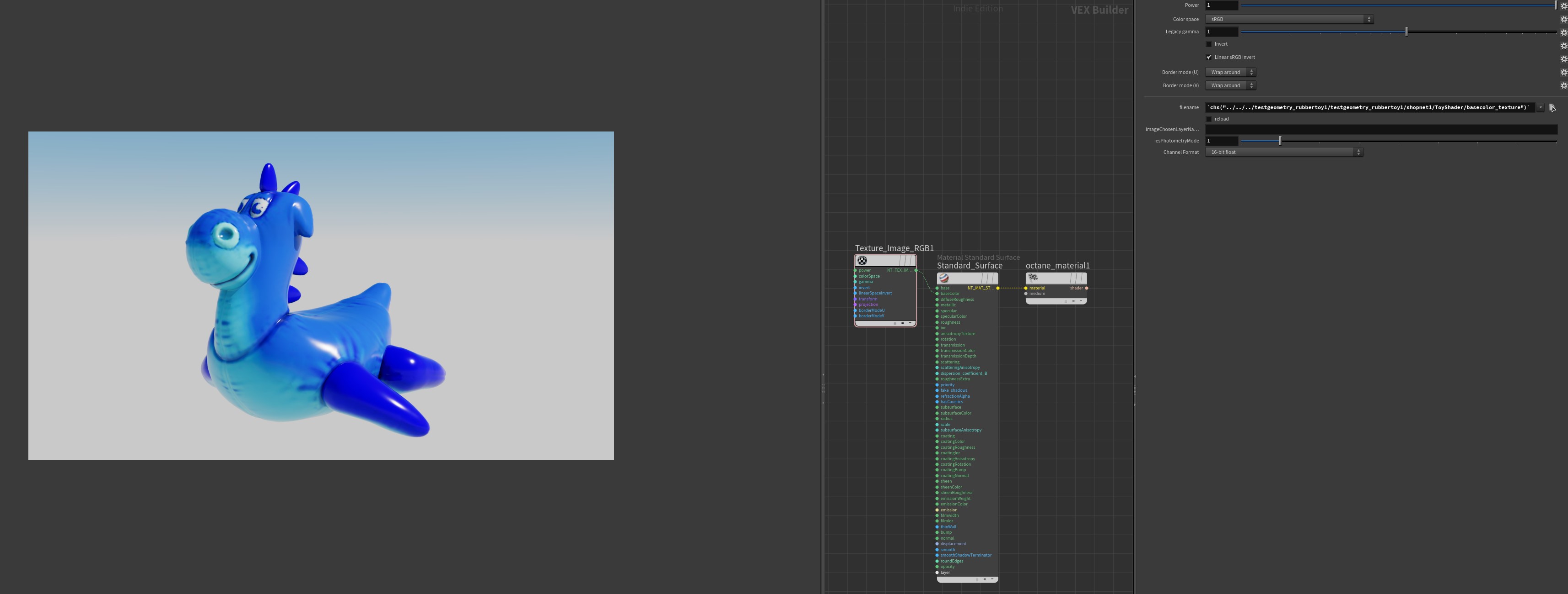

You might want to share a simplified scene for us to debug.
Referencing paths works.

I'd love to share guys, but we have some commercial HDAs in the file :| We managed to figure out, that the scene uses a rather strange string attribute to assign random textures for the book objects. While other renderers have no issue reading these, for some reason Octane can't read these when rendering - OGL viewport preview works fine.
We've dropped a message to the developer and waiting for an extended explanation how exactly the scene is set up.
Thanks!
mirocreative
Posts: 47
Joined: Fri Jan 17, 2014 2:26 pm
Location: New York
After talking to the HDA dev, it looks like Octane would need to handle material_override for the random textures to work. We have a thread from 2019 where it is mentioned as a planned core feature by juanjgon, but I guess it didn't make it to the production versions.
