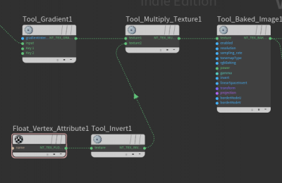

If I multiply a procedural texture with a point attribute (Float_Vertex_Attribute) the Baked Image is incorrect and does not take into account the attribute color.
Setting the multiply node straight to Base Color for example I can see the wanted result properly.
Is this a core limitation or a Houdini bug?
Thank you Juanjo! Weird how no-one asked for this before. It is extremely useful in Houdini to control the displacement texture for example (UV not vertex) with point attributes.juanjgon wrote:This sounds like a core limitation. Standalone probably has the same issue. I'll report it to the core devs.
-Juanjo
