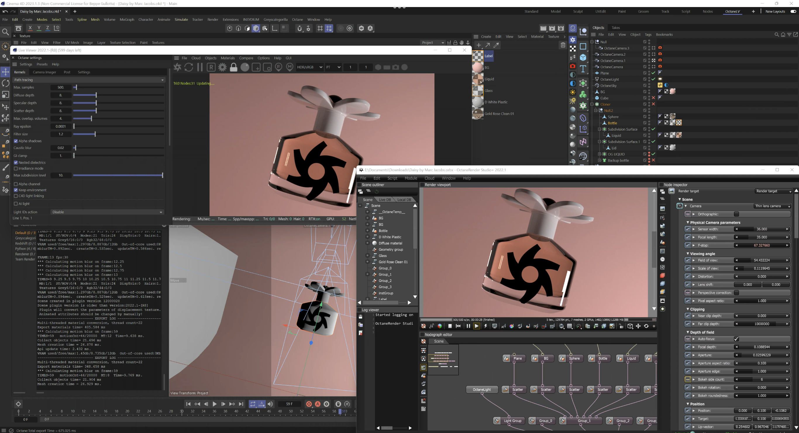

They render fine in Cinema4D but when I open the ORBX files in stand-alone the projection is messed up. I checked the texture settings in stand-alone and it's still Mesh UV. Does anyone have any idea why this could be happening?
See these two images for what I'm talking about: https://drive.google.com/drive/folders/ ... share_link
Also included in the drive folder is the C4D and ORBX file.
Thanks!

just tried with c4doctane 2022.1-R8, and the export has worked as expected here:
Please upgrade c4doctane to 2022.1-R8 and report back, thanks:
viewtopic.php?f=85&t=80831
