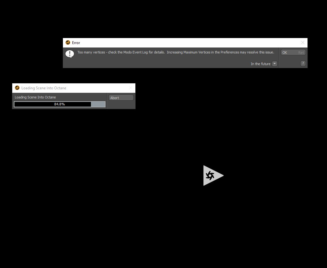

Hi, I need help with this error message I'm receiving from time to time (seem rather unpredictable). Error being "Too many verticies".
My current system is:
Laptop 16gb ram with GTX 1080 max Q for the veiwport, and an external GTX 3090 24Gb for rendering.
What should my Max vertex settings be?
I have tried many different numbers and somtimes the render kicks off, but other times the same scene won't render even though I haven't
changed anything.
Happy for any type of feedback
Best regards
David
face_off
Posts: 15811
Location: Adelaide, Australia
Hi David - increase the Maximum Vertices in the Preferences->Octane panel to resolve this. Mouse-over that preference for additional information on what setting to use.
