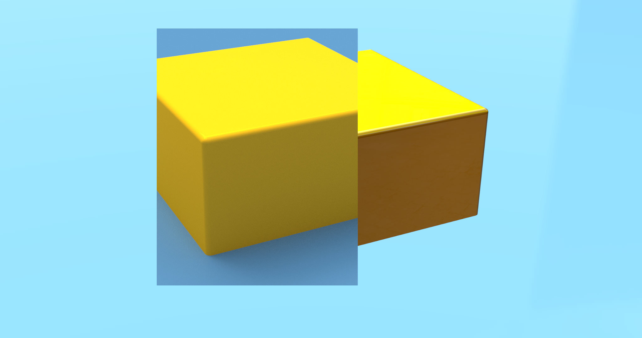

A minor thing, but in case it hasn't been logged already, the render region tool doesn't seem to line up correctly in Solaris (tested on PC and Mac).
Solaris render region

tripledistilled wrote:A minor thing, but in case it hasn't been logged already, the render region tool doesn't seem to line up correctly in Solaris (tested on PC and Mac).
Hi tripledistilled,
Thanks for reporting this issue.
The RenderRegion is now fixed for the next release!
Cheers
