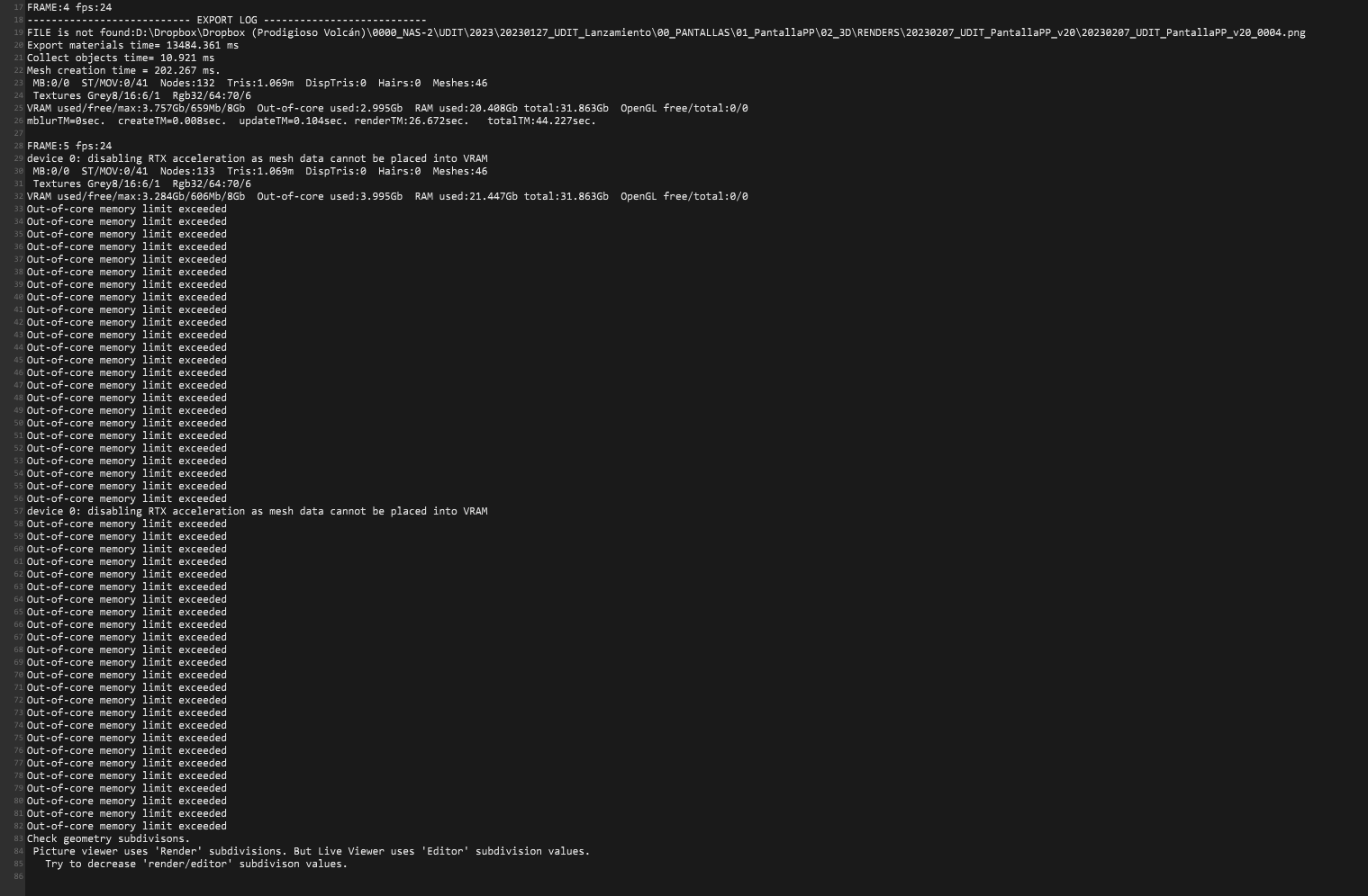

Hi. I've got three similar scenes, the first render worked fine but then it started appearing an error. The weird thing is that the error don't appear since the very first moment, it appears after a couple of renders. I don't think that geometry or subdivisions are the problem, cause the first scene was even more complex.

You might try using the "empty texture cache" option in the Materials menu before starting a new render. Also, check in Octane Settings>Settings>Devices>Device Settings, and that will give you a good idea of where most of your memory is being used. Knowing that, it may help you troubleshoot and find the source.
