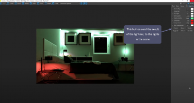

Here is an example in CoronaRender:
Hi Ssmolak, no I'm looking for a way to send the settings of the light mix, into the lights of the scene.SSmolak wrote:"OUT" view is a mix of all render nodes including LightMix - isn't that what you're looking for ?
aoktar wrote:We didn't add this kind of feature, but easy to do.FxDesign wrote:Yes I know this tab in octane, and the "Out1" view.
But once you're happy with the lightmix, how can you send it back to the lights of the scene ? (I don't find a button for that)

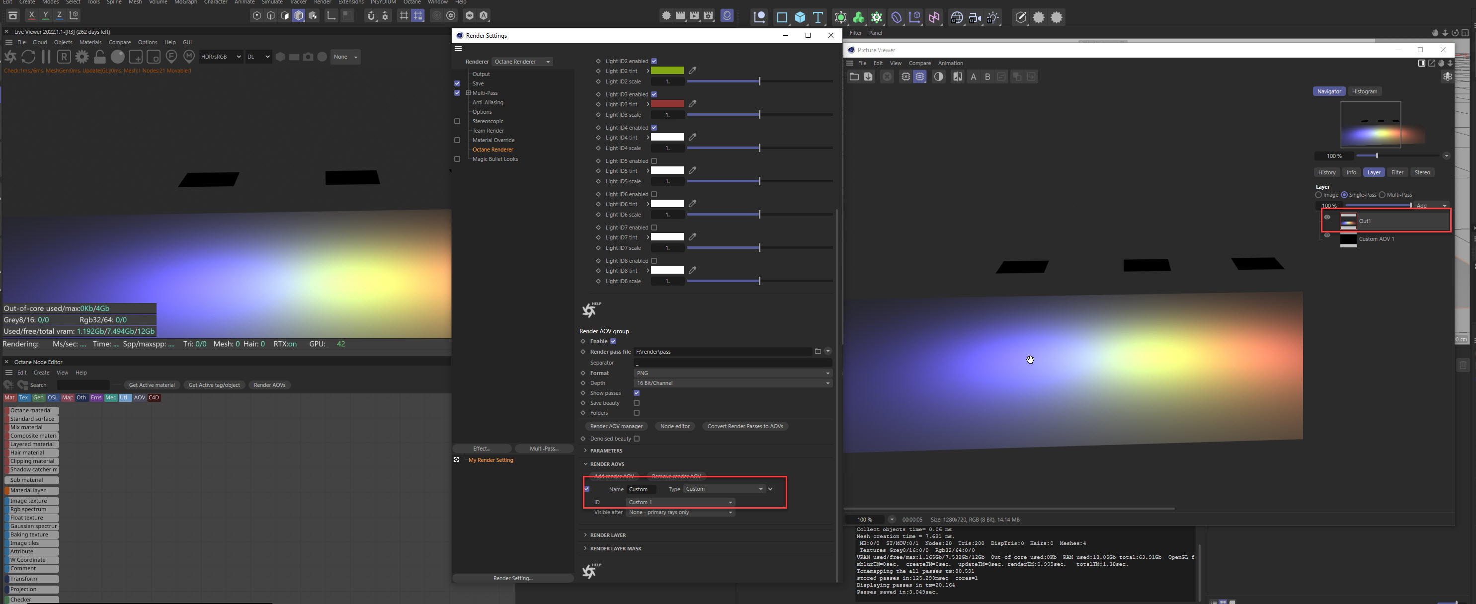

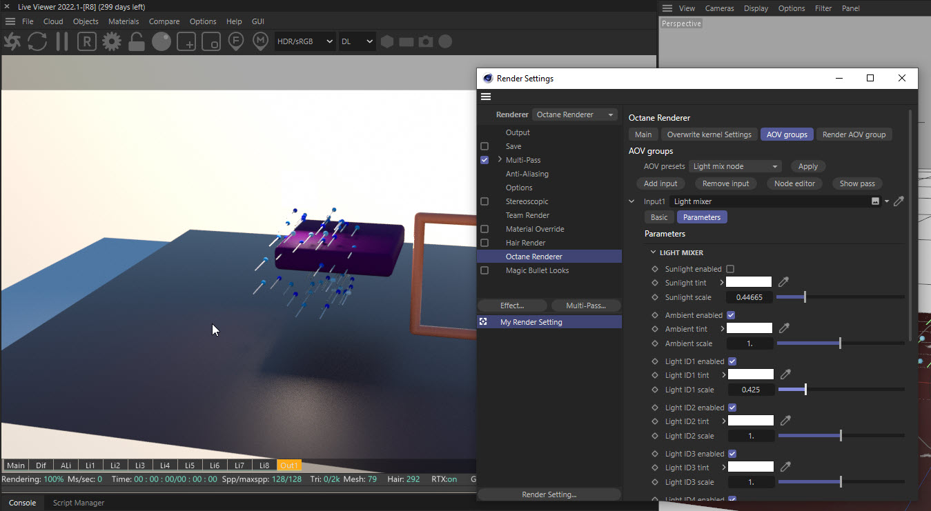

You can save it by this AOV in PV or save directly from LV. See picture Transferring the multiplier to scene is possible but here's a handicap. When I multiply the lights with mixer's parameters it needs to be reset. Otherwise it be multiplied by 2x.shogun3001 wrote:I want to jump in on this and say I would love for this to happen and opened light mixer for the first time and was immediately pumped at the results I was getting. I wanted to render the result, but was disappointed there was no way to render without AOVs (exr) it would be handy to able to print a quick .mp4 out of the light mixer. I couldn’t find any means to do that without rendering an exr sequence, am I missing something?
The button to convert light mixer’s lights to scene lights is would resolve my issues as well.
I am putting a hard beg/request for this feature PLEASE!
