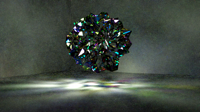

I use Octane so far for casual renders, mostly using "Daylight" setting for the light. That setting never seemed to give any Caustic effects. Does sun light really cannot give caustic? Is there a way around this.

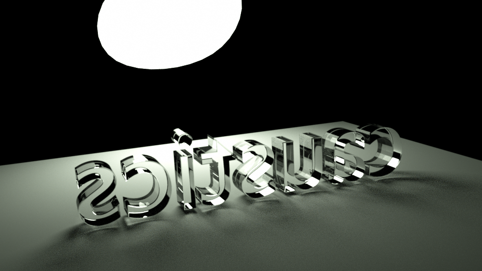

Just now, I tried another setup using object to act as light emitter, interestingly enough caustic light effect appears when using Pathtracing. But the problem of using an object as light emitter is the shadow it is casting over the scene. Is it possible for something to act as light, but not casting shadow?
It's basic, but maybe it is not addressed completely in documentation.
I attached a really simple setup. Maybe Radiance has a good caustic setup example?

						Sunrays doesn't pass through glass, so you won't get refracted caustics with daylight illumination, but you will get reflected caustics. Try a HDRI env. for caustics.
							No.enzyme wrote:Is it possible for something to act as light, but not casting shadow?

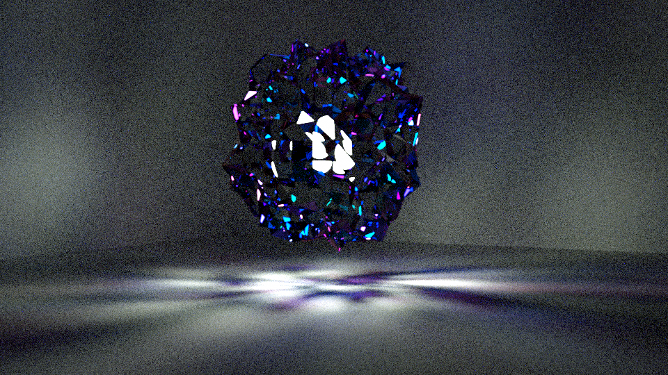

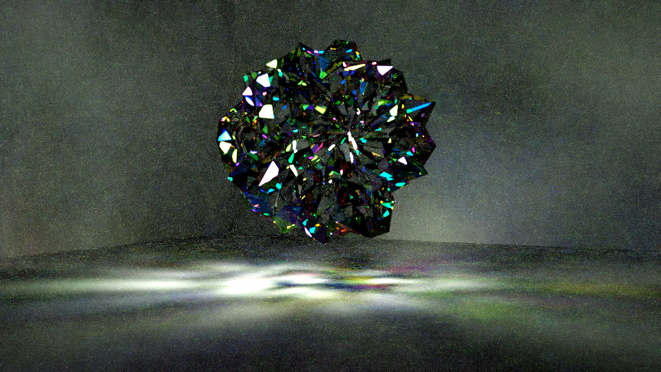

By controlling the roughness of glass?enzyme wrote:But I wonder how to control the caustic result to be more focus or more blur.

Previously I use the film on specular material, but this one I just use multiple materials on mesh faces.
I wonder if there is a trick to get proper directional sun light that result in caustic.
