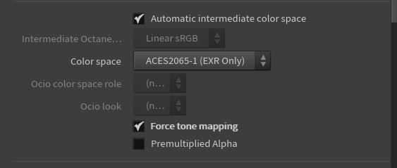

juanjgon
Posts: 8867
Location: Spain
What happens if you enable the "Force tone mapping" option in the Octane ROP, Output tab?
Thanks,
-Juanjo

juanjgon wrote:What happens if you enable the "Force tone mapping" option in the Octane ROP, Output tab?
Thanks,
-Juanjo
Hi Juanjo
Thanks for getting back to me, this is exactly the feature that I was assuming works, but it doesn't.
I attached the test
Regards
