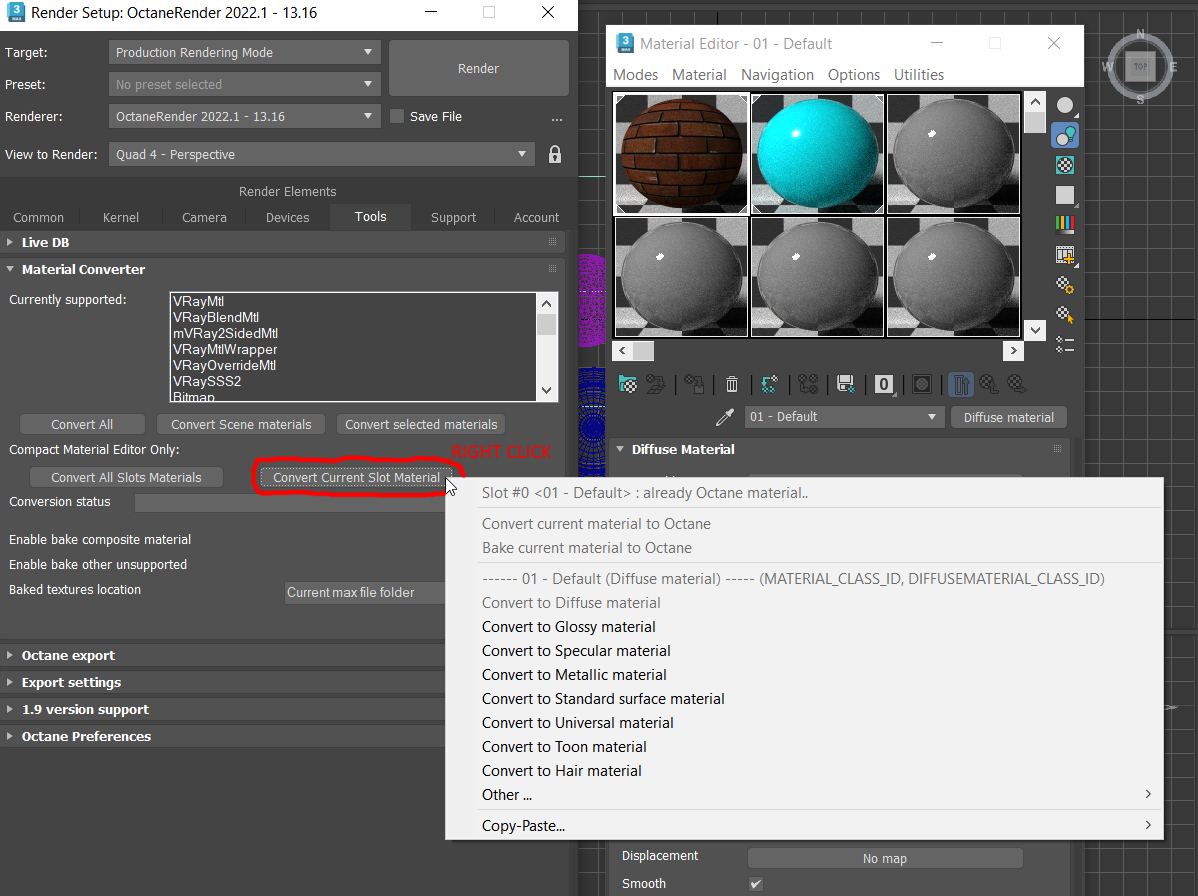

The conversion options are available on the 'Convert...' button in each material dialog.
This is also available in the context menu of the 'Convert Current Slot Material' button, in Tools / Material Converter of the render settings dialog.

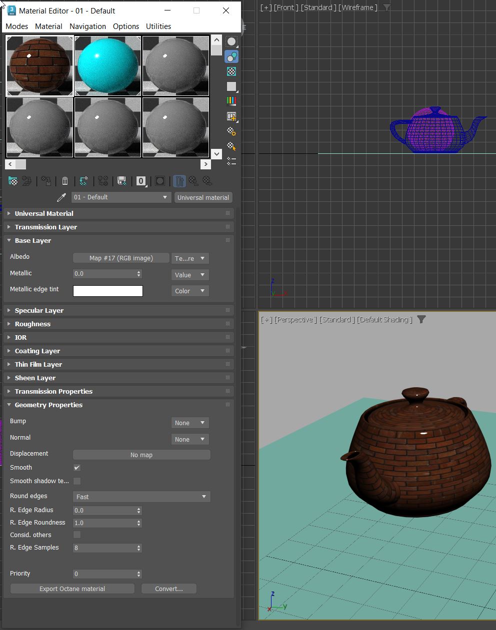

-Open MtlTypeConvert01.max
-Open the Material Editor in Compact mode
-Select the first material :01 - Default (a Diffuse material)
-Left Click on 'Convert..." button, select 'Convert to Universal Material'
01 - Default is now a Universal material, with parameters set from the previous Diffuse material.
The teapot material has been changed to the new material.

-In the context menu of the 'Convert Current Slot Material' button, in Tools / Material Converter of the render settings dialog.
-In the context menu of the 'Convert All Slot Materials' button, for operations on all the Sample Slots (Compact mode)

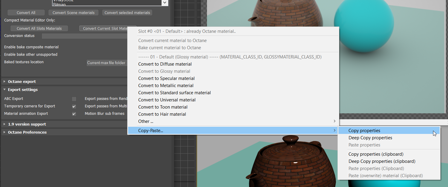

-Select the RGB image in a slot if the Material Editor (Compact mode).
-In the 'Convert Current Slot Material' context menu, choose 'Copy-Paste.../Copy properties'
-In a new slot, create a Grayscale image
-In the 'Convert Current Slot Material' context menu, choose 'Copy-Paste.../Paste properties'

-In Max2022, open the Material editor (Compact mode), and select a material.
-In Render Settings, Tools / 'Convert Current Slot Material' context menu, choose 'Copy-Paste.../Deep Copy properties (clipboard)'
-In Max2023, open the Material editor, and select a slot to receive the material
-In Render Settings, Tools / 'Convert Current Slot Material' context menu, choose 'Copy-Paste.../Paste properties (clipboard)'
