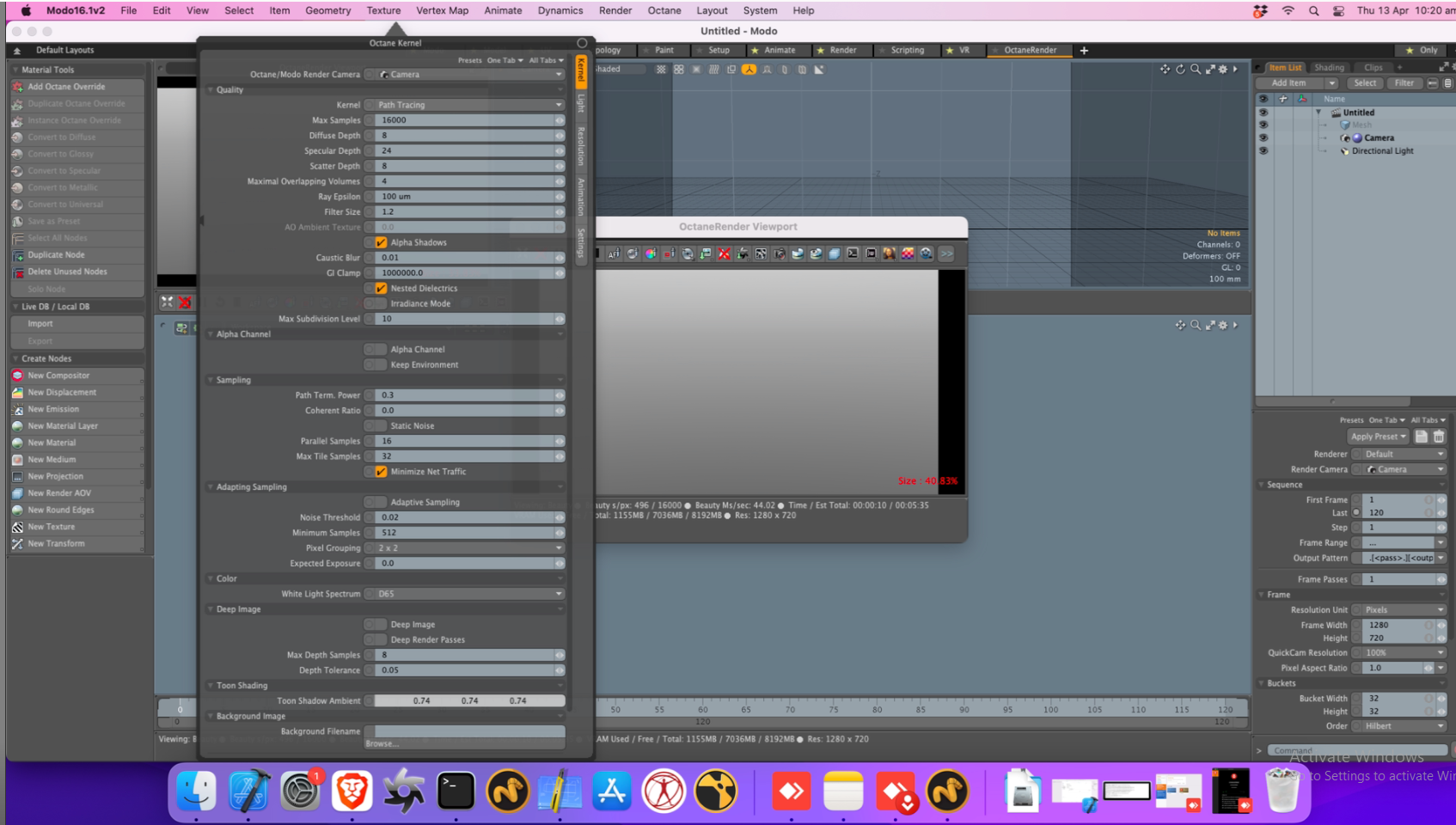

I am doing the macOS release, and was unable to reproduce your issue. Please see the following screenshot, which shows all is OK? Are you able to give me more details on how you are getting the error to occur please?
Paul

It seems this was a transient error in Modo 16.1v1 - in 16.1v2 (that I just now installed on the Mac) I no longer see this issue.
Long story:
To be sure I ran some test.
In Modo 16.1v1 (the one I reported the error initially for) I still can reproduce it reliably: Simply open up Modo, open the Octane viewport and click on the "Kernel" button.
The kernel options pane will be displayed behind the viewport window and will be closed automatically as soon as you activate the viewport window again (thus making it impossible to just move the viewport window out of the way - one instead needs to resize it to get to the kernel options pane). The same is true for all other option panes (camera, environment, ...)
Also, the viewport window has such a high window tier that it will stay on top of all other windows of other applications one switches to, often making it necessary to close it if one wants to just take a quick look at some content in another app (as it usually takes up a large part of the screen).
Now, I also tried to reproduce it in Modo 16.0v4 - with lesser success. In Modo 16.0v4 this only happens for the log window - that one is opened below the viewport window, but all other panes (kernel, camera, ...) are opened above it. And the viewport window also does not have that high a window tier - when I switch to other apps, it falls below their windows.
So I downloaded and installed also 16.1v2 to check: And it behaves exactly like 16.0v4 !!!
So no issue there and the window tier in 16.1v2 clearly is lower than in 16.1v1 - I can switch to other apps and the Octane viewport falls below the other app's windows. Only the log window opens behind the viewport window (as in 16.0v4).
So it seems that in Modo 16.1v1 as a transient error the window tier of windows created with "style:standard" was simply too high.
