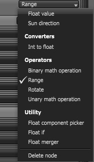

In Standalone every node input can have basic connection - even for sun direction, that can be used for connecting more advanced nodes not listed here :aoktar wrote:too?

This Sun Direction paremater from Standalone is very good. Some time ago I asked for feature like this but I didn't know that Standalone has this by default.
