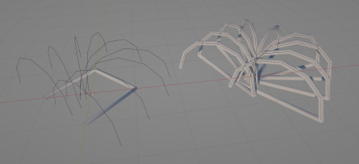

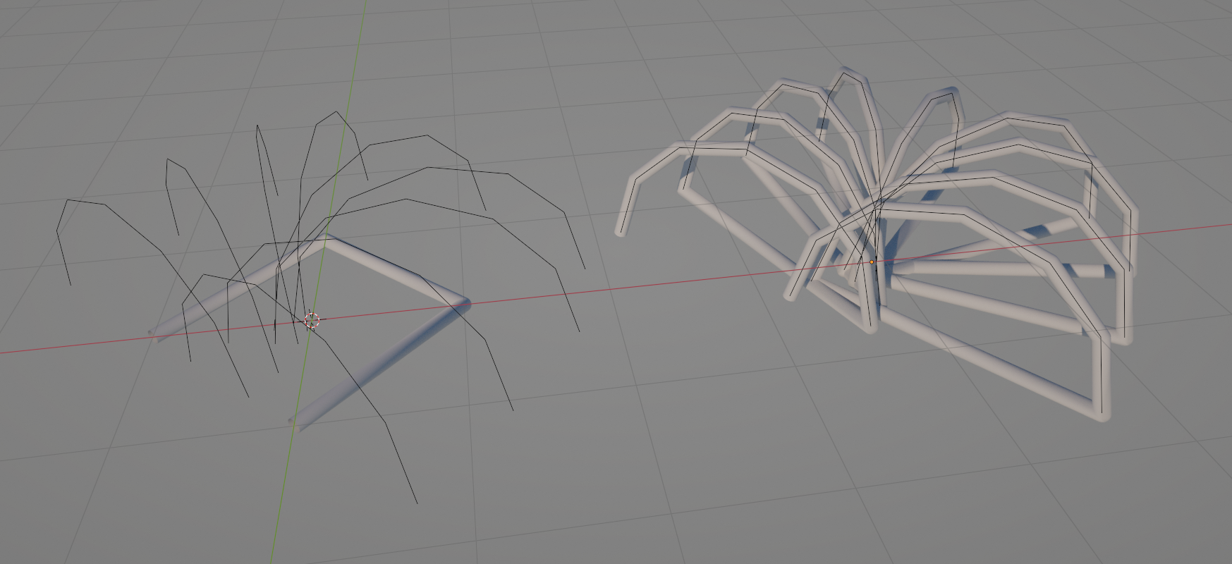

I'm having two problem with curves renderable as hair in octane.
The first one is the impossibility to render curves instancied by geometry nodes, it just render the original curve.
Second one, if i convert the geometry nodes to real geometry and back to curve, it render but add extra segment between curves, not following the original open shape as you can see in the screen.
Curves as Hair Octane 27.8 on 3.4.1
