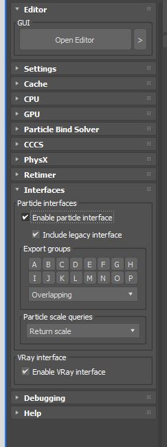

HHbomb
Posts: 1383
have you checked "enable particle interface" ?

Hey HHbomb,
Yes I always do :)

My bad, I didn't know the trick with the "mesh instances" working with particle interface, know I do, thanks !
Loading time is still high but cut by half :)
