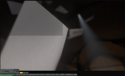

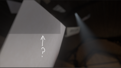

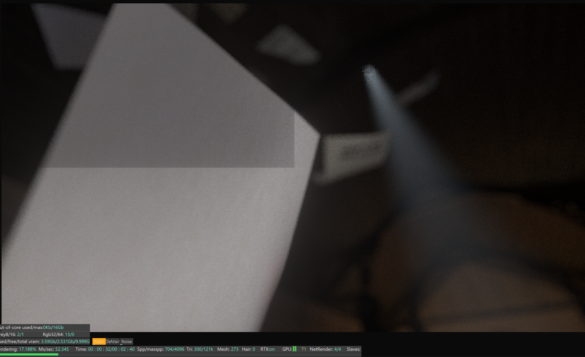

I wonder can anyone explain whats happening to my render. Im getting a dark 'box' on the LV and the PV. This happens when im using network rendering, it doesnt happen when using only local machine.
Since it started I have updated octane, c4d and drivers. It happens in all kernals. I tried new scenes but same result.
Octane 2022.1R6
C4D 2023
local machine - 2 x 3080
slave - 4 x 1080
Cheers!
