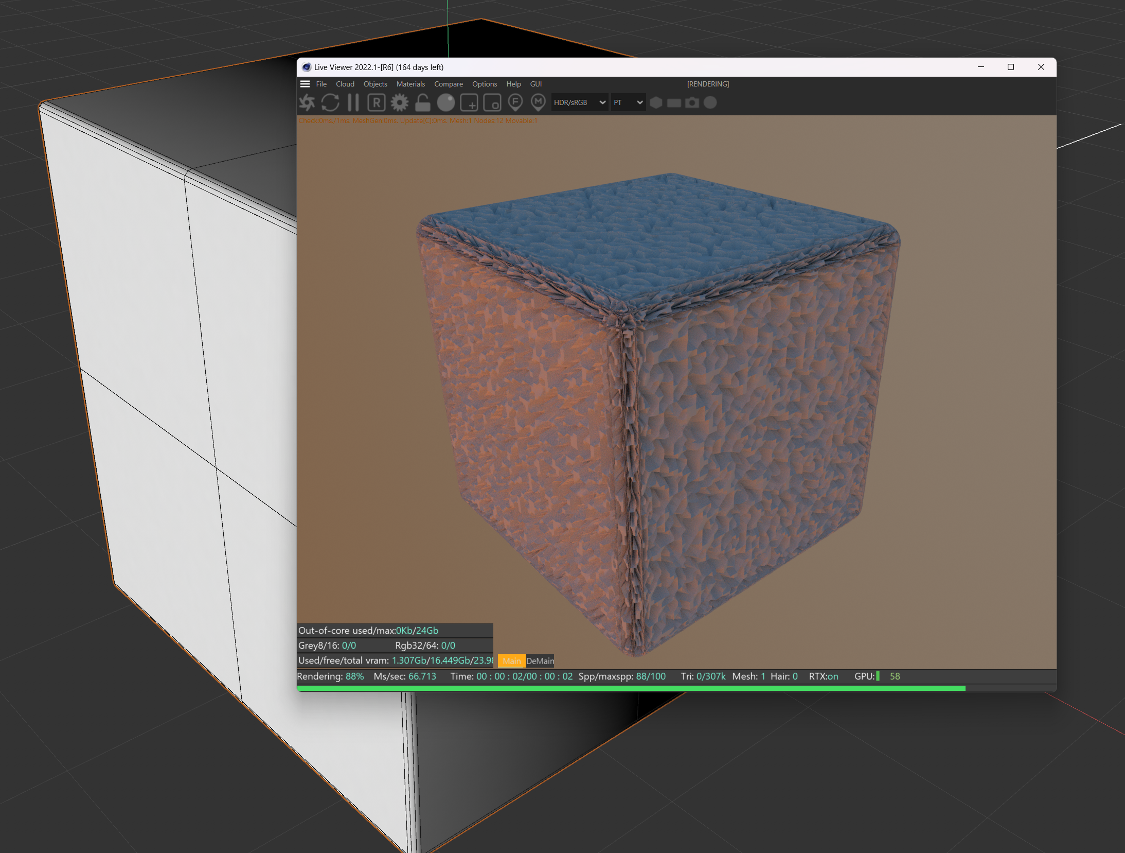

It would be nice if we had more control over how Octane performs its subdivisions so that this problem with vertex displacement: viewtopic.php?f=30&t=81129&p=421718#p421718 -- can be solved. The general gist of the problem and solution is that meshes without perfect distribution and sizing of polygons results in the subdivider subdividing the smaller polygons the same number of times as it does the larger polygons (and depending on the algorithm chosen, the polygons around those smaller polygons). Example:
When applying procedural vertex displaced textures to this model, you will now get lots of "artifacts" along the bevel, as you can see in the screenshots in the thread I linked and here (same object/subdivision setting as the first screenshot):
At first I thought UV maps can help this issue (as per my original thread), but after playing with it some more I'm not convinced it helps. If it does, it's negligible at best. Even with perfect UV maps the problem still exists.
So either we need a smarter displacement smoothing algorithm, subdivision algorithm, and/or a new displacement mode that can somehow average out it's displacement over multiple polygons if surrounding polygons are larger so that you see less of the artifacting, or the ability to control how the subdivider works so that we can tell it not to apply so many subdivisions to smaller polygon areas and bevels.
