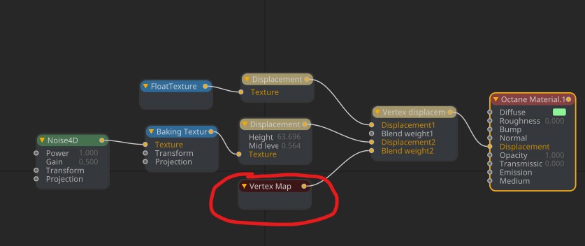

Main problem is that vertex displacement mixer doesn't work with vertex maps :
Strange that Disp Mixer works fine with Field Texture but not in Shape mode :
shape_field_disp_mix.zip
(647.1 KiB) Downloaded 157 times

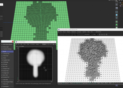

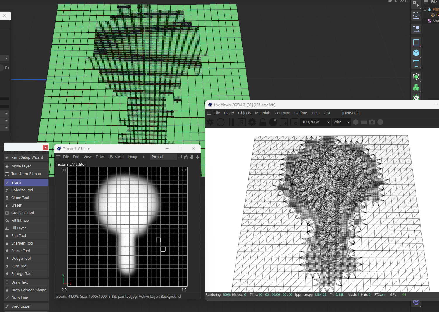

The best is to use image mask with adaptive subdivision creating by this mask :
But painting doesn't work correctly if image is used somewhere in Octane material.
adaptive_vertex_displacement_by_map.zip
(155 KiB) Downloaded 132 times
