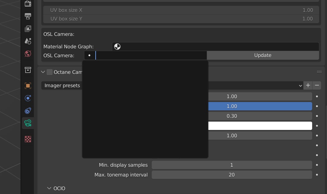

Tell me the instructions for installing OSL Camera. Now I see an empty list in the OSL Camera section. How to create an OSL Camera?

Check the "Material Node Graph" right above, tooltip: "Material node graph containing target osl camera node".
You need to have a material somewhere on some object, open it in the Shader editor and add the OSL camera node in it. Then back in the Camera properties you can select that container material and in the OSL camera slot select the OSL camera node.
The OSL camera node can either use an internal shader (new text object with the code, created with the Text editor) or an external .osl file.

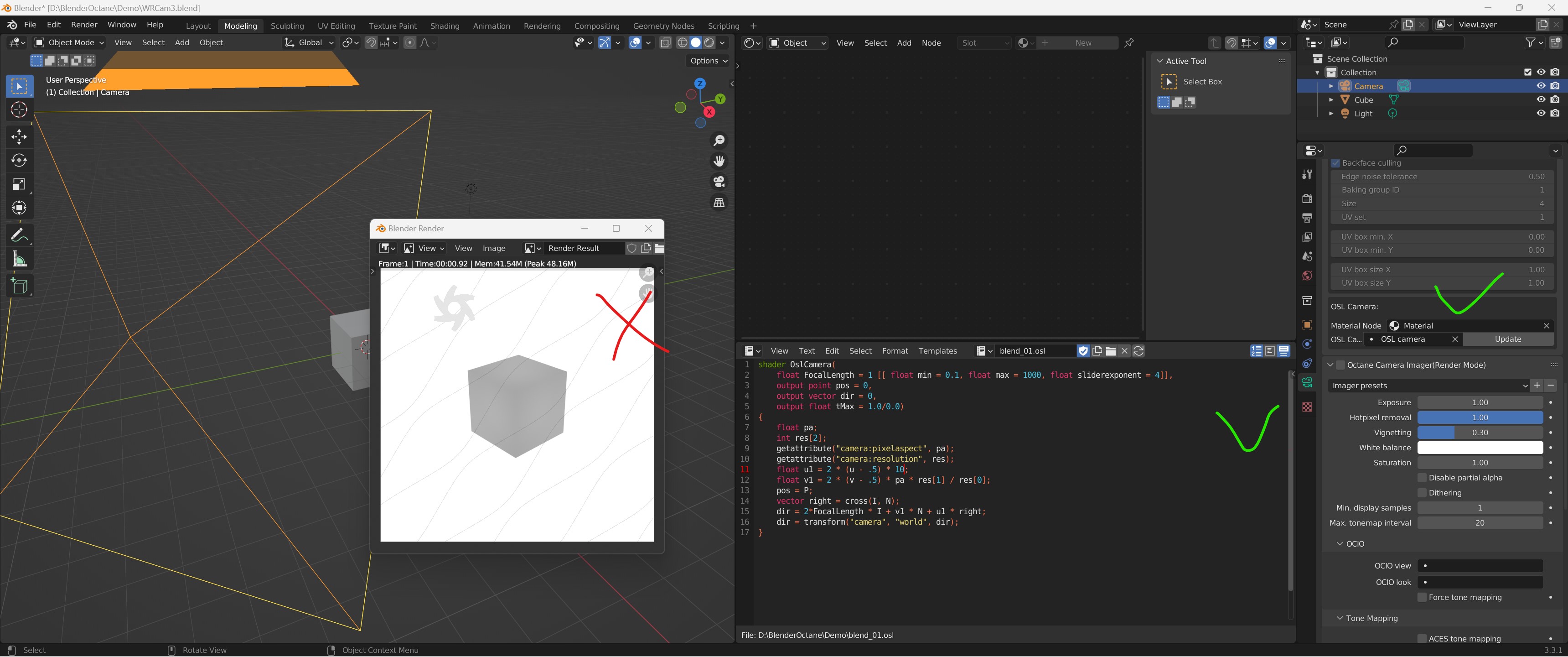

Thank you! I have added an OSL Camera node to the material. It was possible to make a choice of the camera.
I chose the .osl file, but I didn't get any effect when rendering in OctanaRender.
Can you help me achieve the OSL Camera effect? Do you have example files?

I have several good practices for using Reverse Perspective with Cinema4d+OctaneRender.
As well as my own build with the Blender reverse perspective patch for the Eevee render.
I want to do reverse perspective for Blender + OctaneRender using OSL Camera.
But the OSL Camera doesn't work for me in Blender+OctaneRender even with minimal changes to the base example.
Please help me find a working Blend file example for Blender+OctaneRender with OSL Camera.
