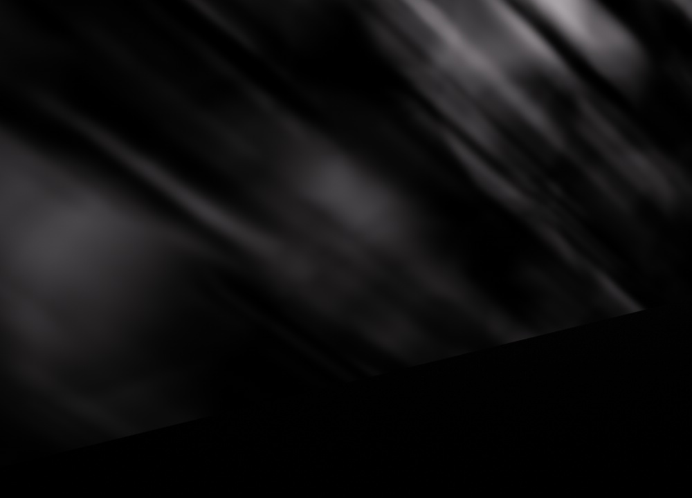

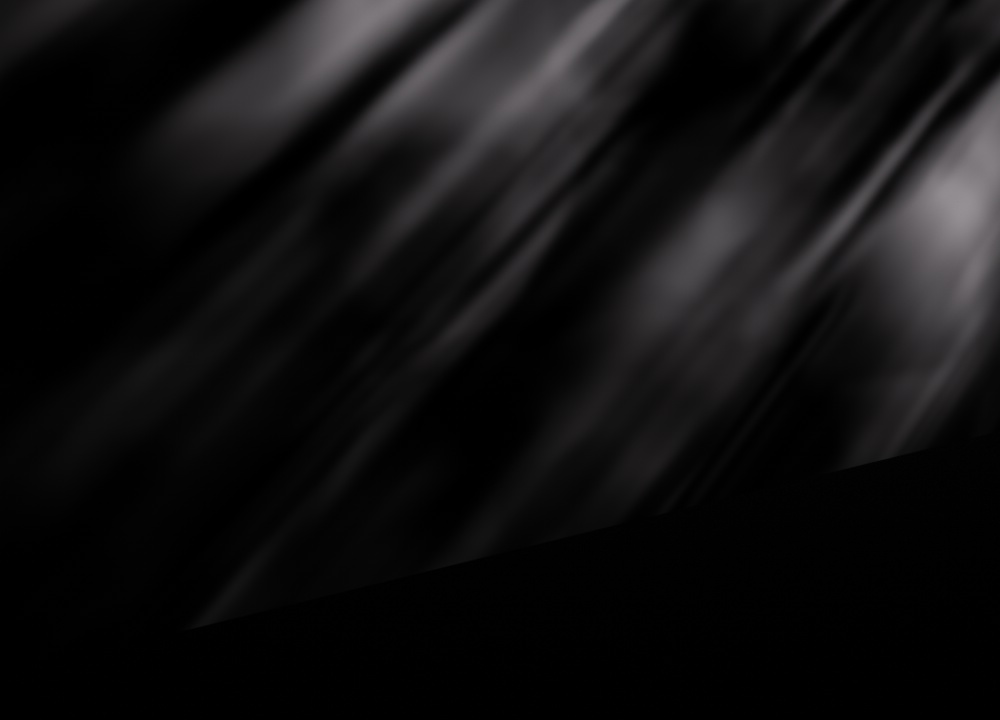

I stumbled on a problem when opening a file setup with Octane 2021 and rendering it with 2022. An area light using an image texture in the Distribution slot renders differently in 2022 compared to 2021.
Attaching a simplified scene file, and two rendered images illustrating the problem. It seems to be a rotation or flipping of the texture. Is there someway to rectify this?

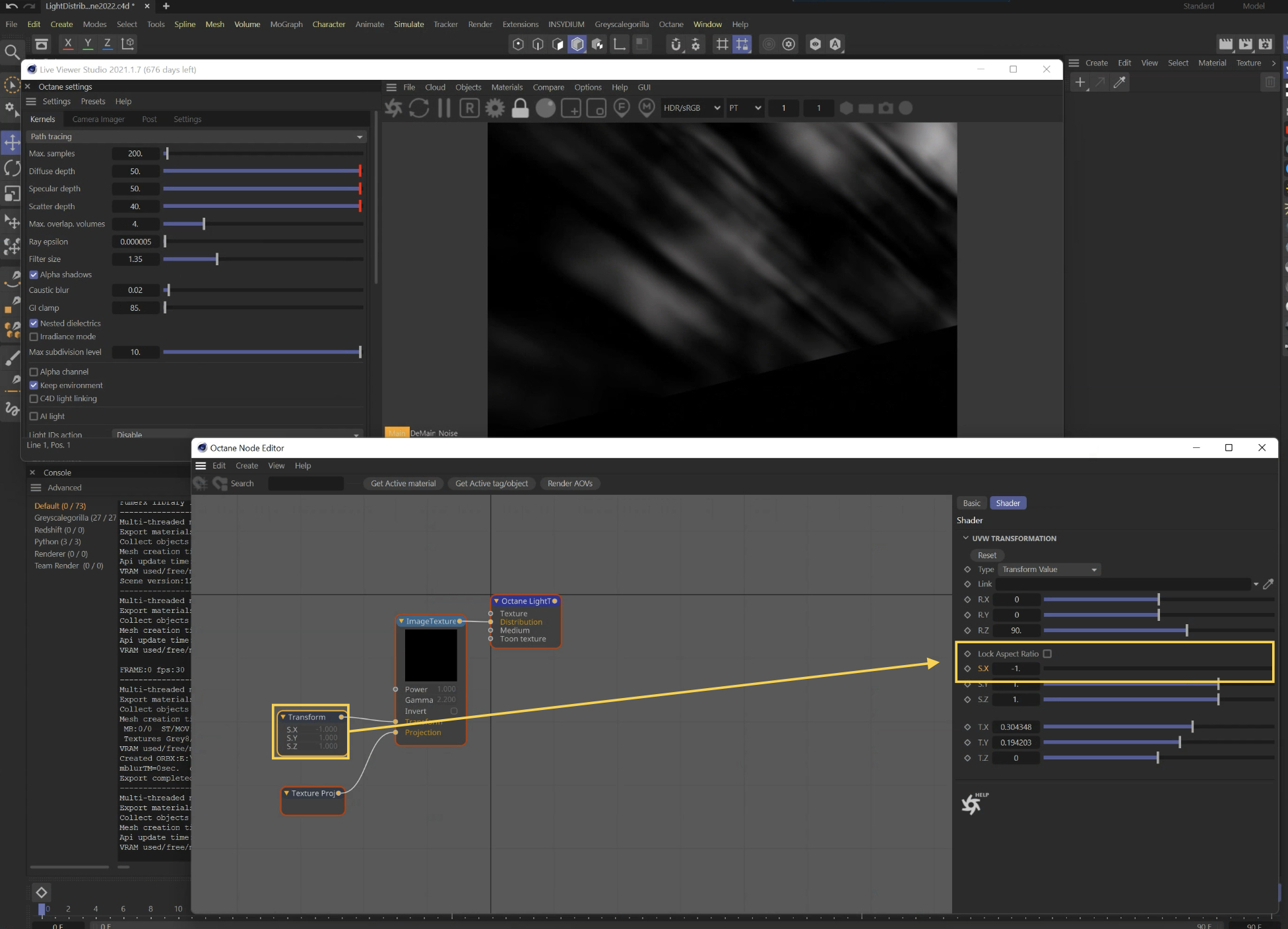

weird, the projection is flipped also in 2021.1.7 :roll:

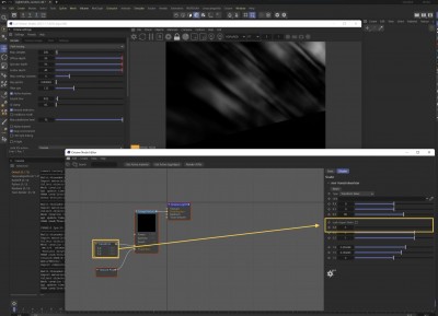

Anyway, to correct it, just select the UV Transform node, disable the Lock aspect ratio option, and set the X scale to -1:
