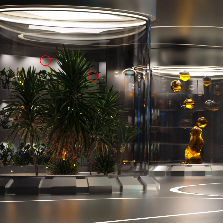

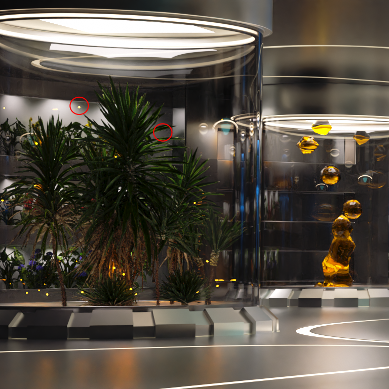

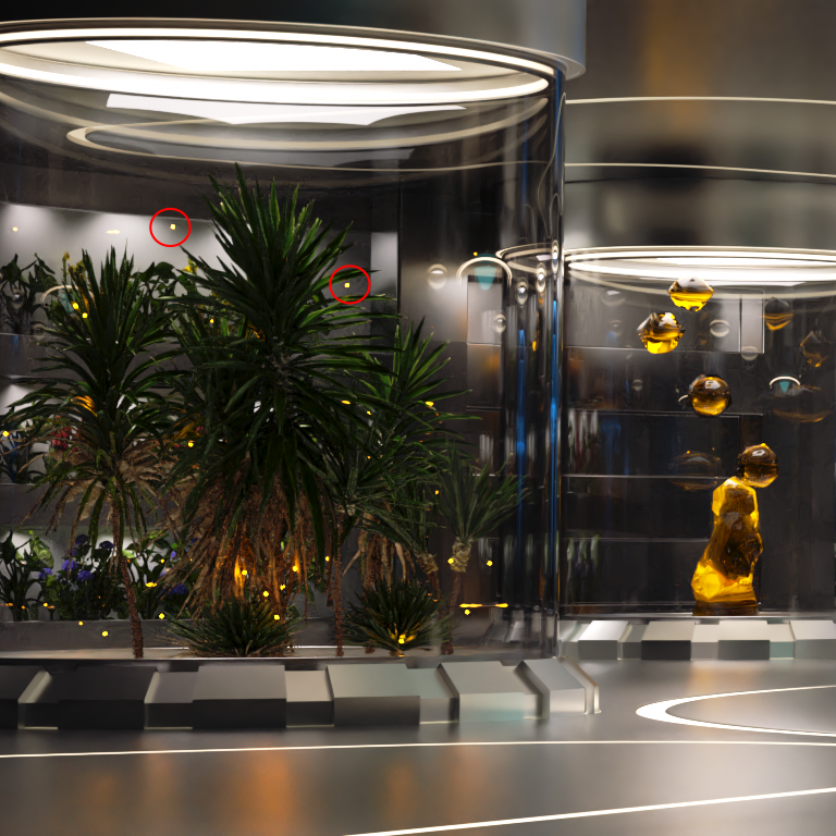

missing particles on renders. im just using the native c4d emitter. below are the pics from 3 frames. frame 504, 505 and 506.
happens a few times already on other scenes. no problems on viewport.
c4d version : 2023.1.2
cuda driver version 12.0
OctaneRender Studio+ 2022.1 (12000020)
frame 504
frame 504
frame 505
frame 505
frame 506

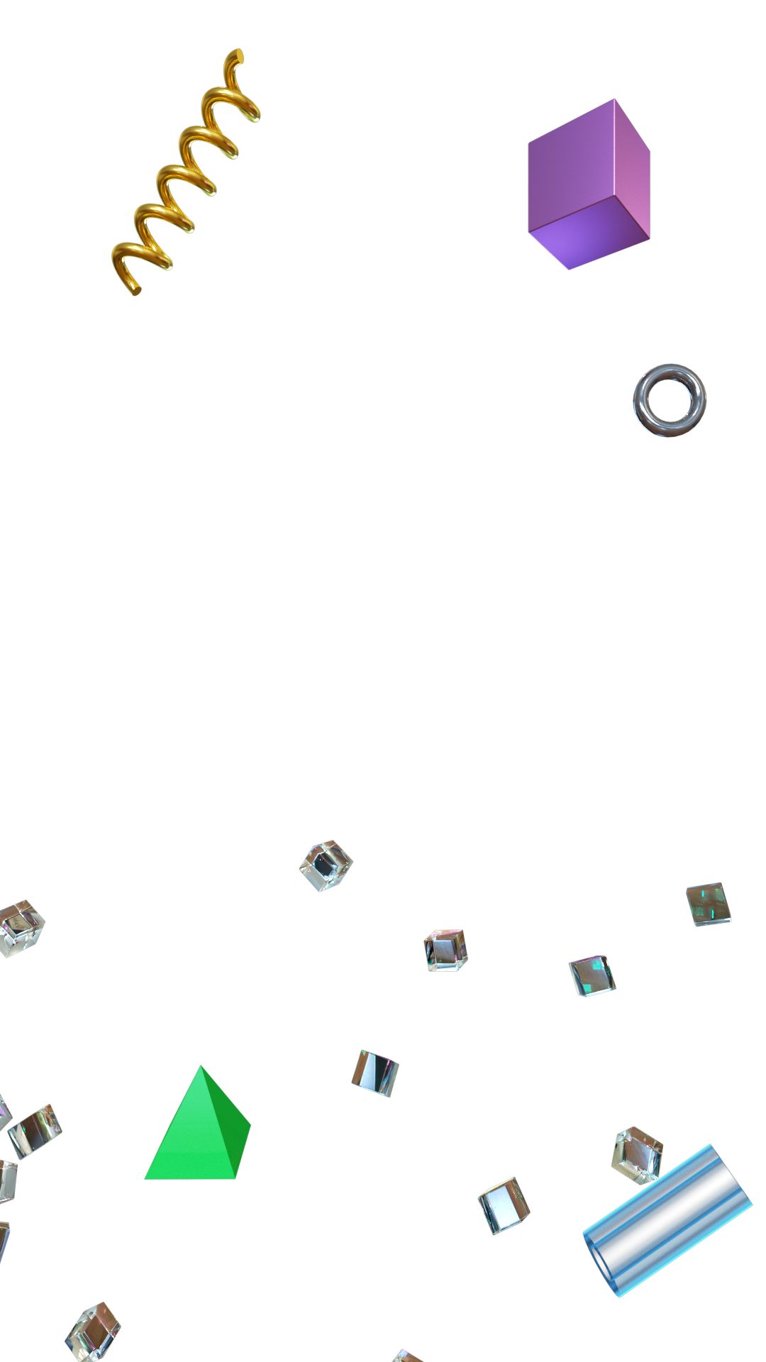

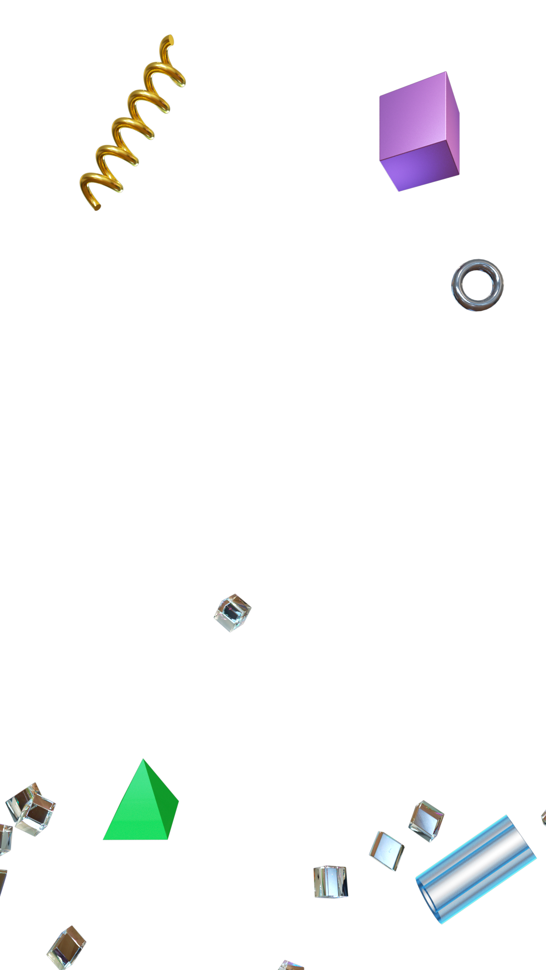

here is a simple test
frame  262
frame 262
263
263
264
264
test.mp4
(4.05 MiB) Downloaded 1442 times
here is the test scene project https://we.tl/t-DYj0ccknlb

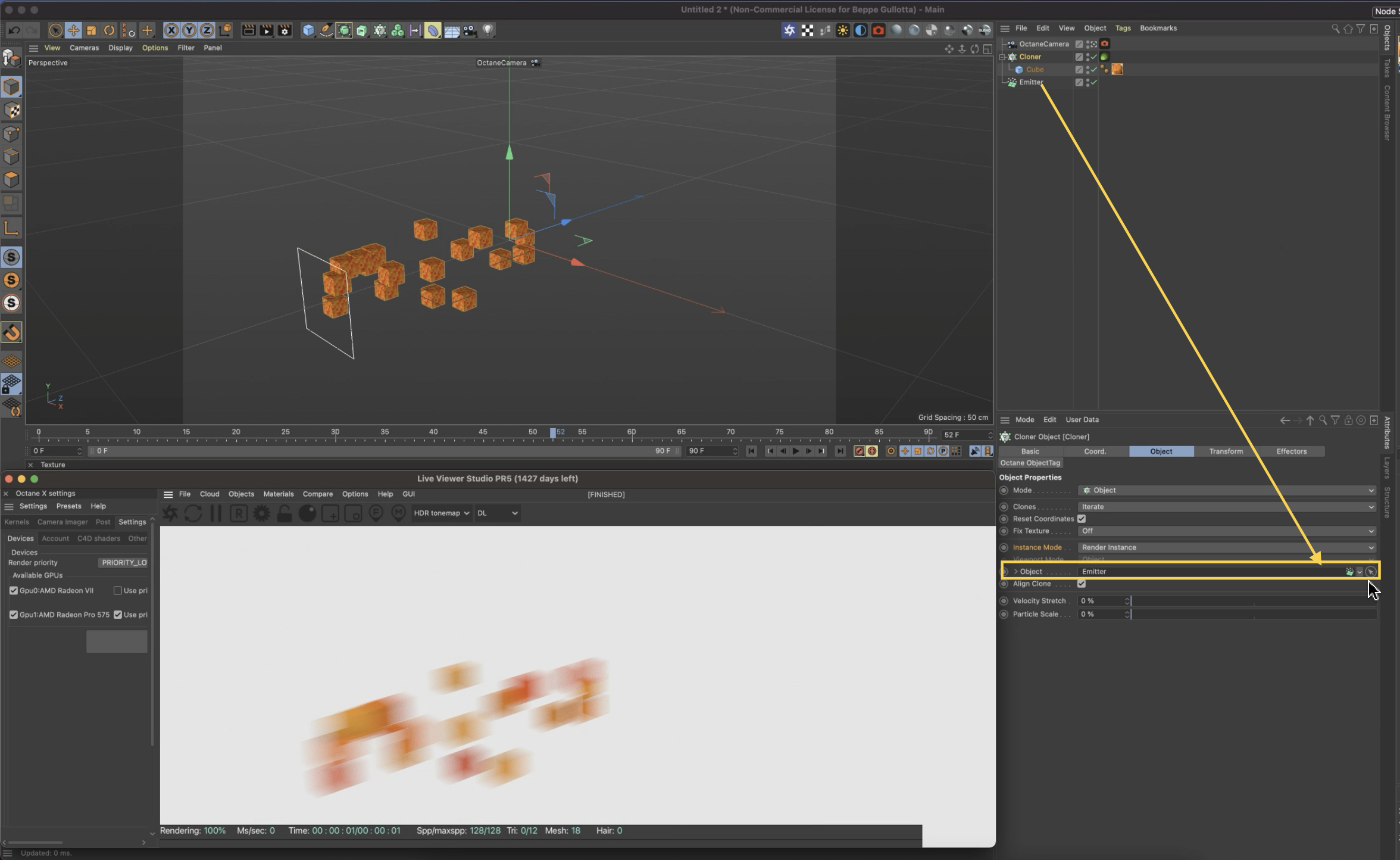

Posts: 10589
Please always use the C4D Particles Emitter as source for a MoGraph Cloner in Render Instance mode.
In this way, also motion blur is supported:
ciao,
Beppe
Posts: 16068
Location: Türkiye
bepeg4d wrote:Please always use the C4D Particles Emitter as source for a MoGraph Cloner in Render Instance mode.
ciao,
Beppe
Yes as Beppeg say you should use Cloner or particles tab from object tag. Otherwise no stable IDs to track the particles in motion engine.
