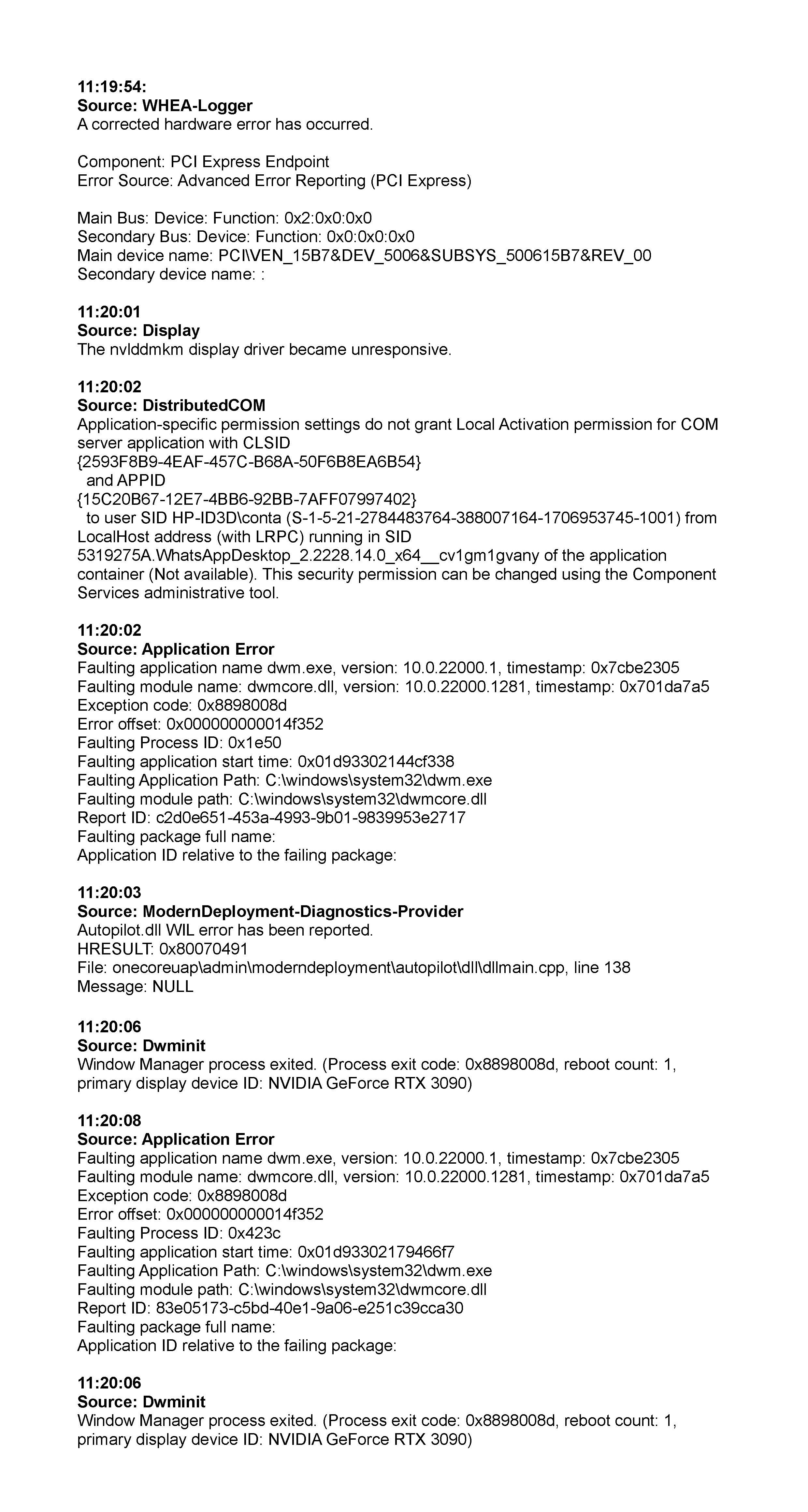

I send a selection of the errors recorded at the time of the crashes, there are 2 which clearly seem to concern the graphics card:
11:20:01 Source: Display The nvlddmkm display driver became unresponsive.
11:20:06 Source: Dwminit Window Manager process exited. (Process exit code: 0x8898008d, reboot count: 1, primary display device ID: NVIDIA GeForce RTX 3090) Thanks in advance for your advice,
