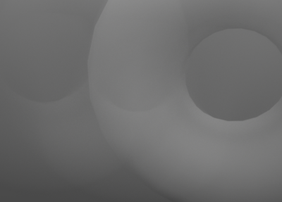

Just noticed, that there is some animation in the exported file, but only on Frame 0
