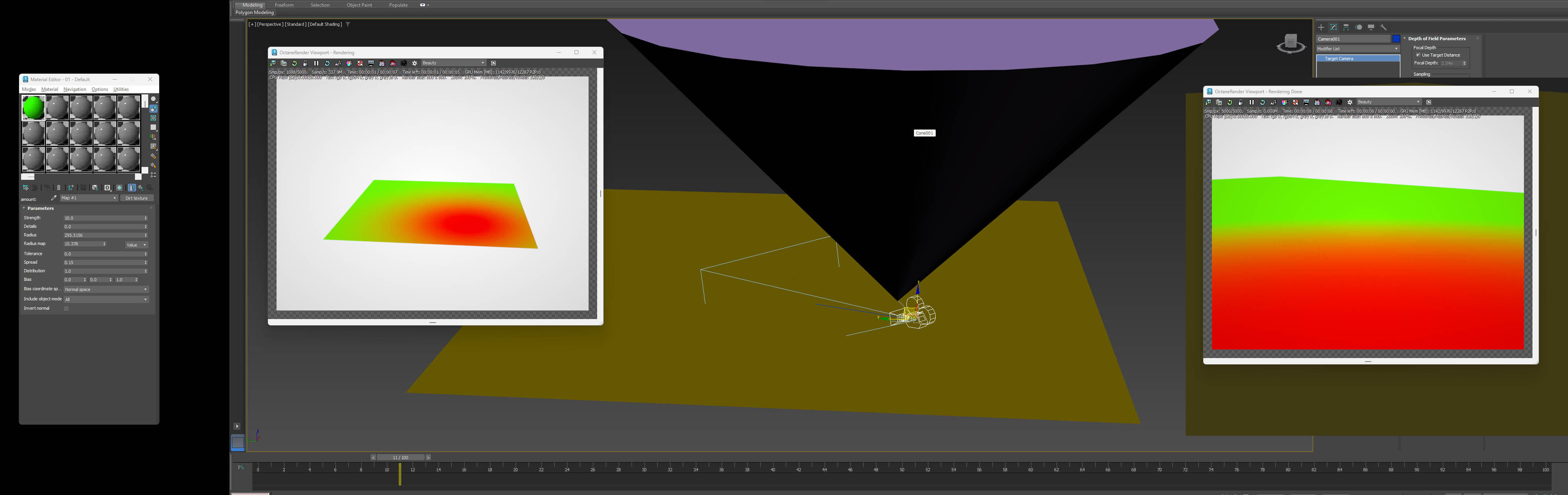

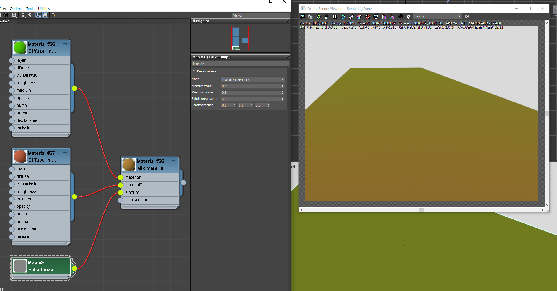

I attached the scene. I tried falloff method. Kind of what I need but I don't need to change color when camera tilts though.
Also dirt texture. But the cone that generates dirt texture can cast shadows if alpha shadows are off. I wish octane allowed non renderable objects create dirt marks
