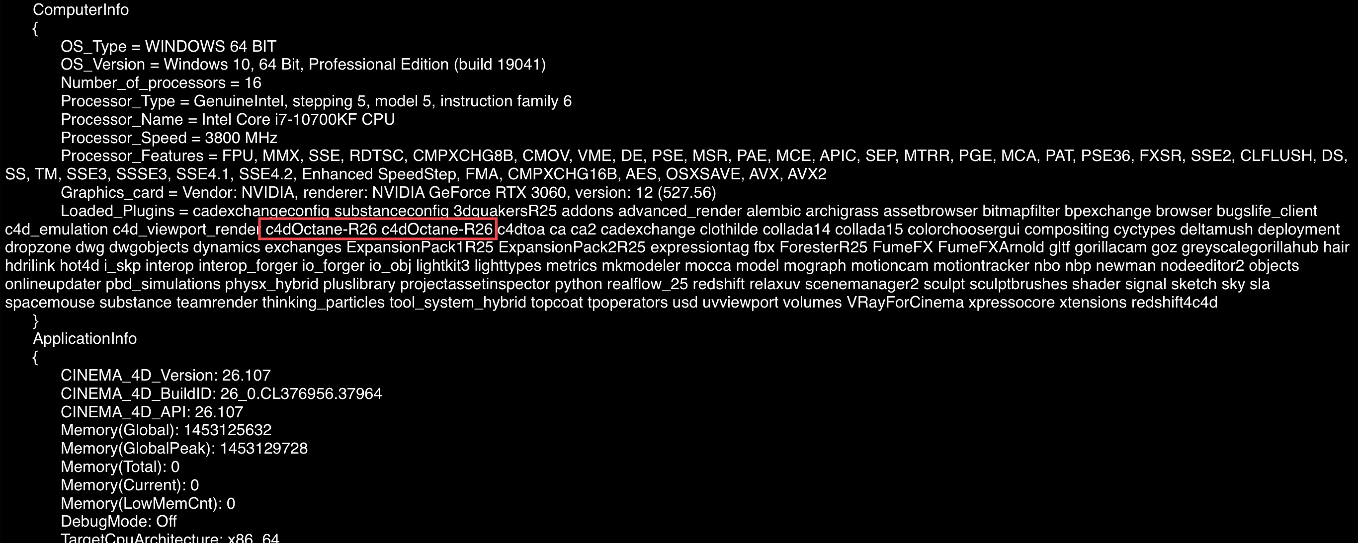

Hi all. I've a crash with the lastest version of Octane. The plugin loading fails and the aspplication doesn't start. Delete Octane plugin and Cinema R26.107 works fine. C4D R25 and C4D 2023 work fine with Octane 2022.1.R4. Only C4D R26.107. Here's the bug report

Update.....it's incredible, but C4D R26 doesn't work with any version of Octane so it is a C4D issue. I don't know what happened. I'm not a guru, I am only an user so I hope somebody can read the bug report and he can tell me which is the problem. Thanks a lot

bugreport shows that c4doctane is installed twice, this is why it is crashing at startup:
Remove the copy you have just installed, then start C4D R26, then go to c4d menu Extensions/Console, (Shift+F10), to know the path of the other version installed, and replace it.

Thanks a lot Beppe. I don't know why but when I have deleted the previous version Win (or C4D) didn't delete it so there were two plugins. A visible plugin and a hidden plugin. I had to reinstall Cinema with a new plugin folder and now it works fine. Problem solved.
